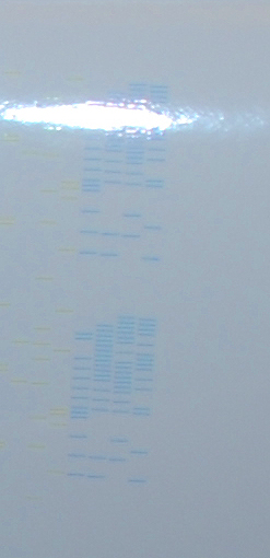

    I printed a job today, but noticed that the machine was only printing with CYAN ink.

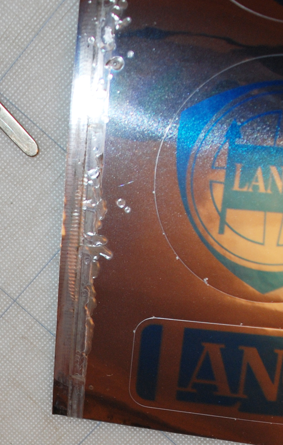

    The print quality was fine, but there was lot of ‘gunge’ being left at either side of the material and under the rollers.
    The ‘gunge’ is fairly clear stuff on the whole, but with the odd bit of black matter.
    (see photo attached):
    Then the print quality went on the CYAN too. Black, yellow, magenta have gone, and don’t show at all on the nozzle check.
    (see photo showing the very little that’s left on the nozzle check):
    Any advice on steps to fix the problem would be appreciated.

    was it sticky then dried still sticky or took a age to dry. what residue other than ink is in the cap top

    The ‘gunge’ dried up fairly quickly.

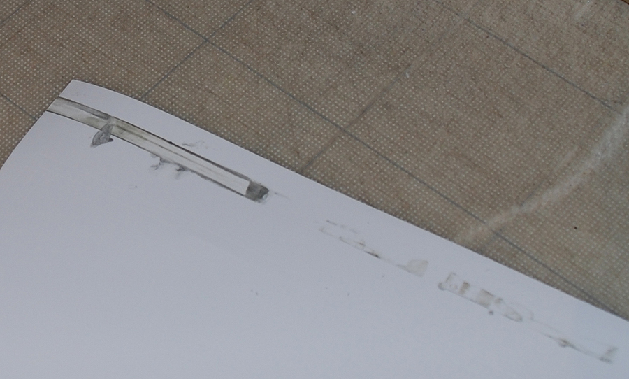

    I tried to do a cut job since, and it deposited something that looks like it’s from the dregs of white ink cartridge.
    A day after I lost the print function, (yesterday Sat.) I got the warning beep that the white cartridge was empty.
    The consistancy of the ‘gunge’ is either clear with black particles in it, or sometimes the odd lump of white.

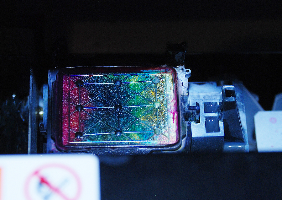

    The cap top looks normal. I’ll take a photo of it.

    Here’s the cap head Chris:

    Here’s the ‘gunge’ that it left in the middle of the last ‘cut only’ job.
    As well as the same stuff under the right side roller.
    There was quite a lot of solvent in it, it seeped into the cut lines and made a mess of the ‘cut only’ job.

    yes was thinking it was from either white or silver clear carrier
    the cap top is desperately in need of replacement as its wet so not clearing well enough with will have affected the other colours. presume you dont use the white often needs a new cap top every 6 mts because of the white.
    has this been converted to the max2 white yet.
    i would fit new wiper felt and cap top (genuine only) and head soak for a day before one powerful clean hopefully all will return.

    The cap head looks completely normal for a healthy machine. As in, the distribution of ink colours.

    ink deposits at one end of the travel normally means the wiper is not doing its job or damper problem
    the cap top if not sealing will lead to poor cleaning
    if the cap top is wet (like your original pic) then either blocked or pump not scavenging blocked pipes etc even the pump its self, ink on the gears is a give away.
