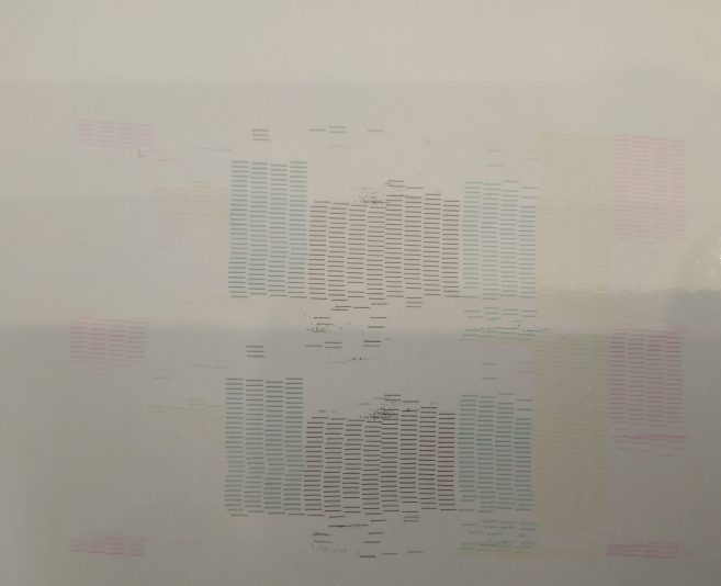

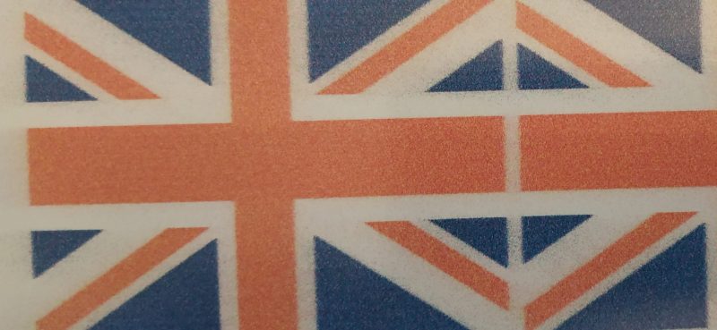

    Hi, Started a few days ago havng problems with the print on my BN-20, did test print and nozzle checks and both were patchy and faint, I changed out the wiper and felt hoping there might be an improvement but still the same, I have replaced the capping station but still having the same issues, the print is faint and blotchy, any suggestions would be appreciated.
    Thank you.

    I would say that you need new heads looking at the nozzle check. So many nozzles missing/blocked.

    Have you tried cleaning? It looks like you’ve maybe had a head strike. Try soaking overnight, and see what it looks like tomorrow. Otherwise, I’d say an engineer visit, and possibly new dampers or head.

    Have you tried replacing the dampers?
    It does look like the same area over a few colours, so could be a head strike.

      I sent the pictures to a Roland Tech and he said he’s pretty sure the heads are goosed.
