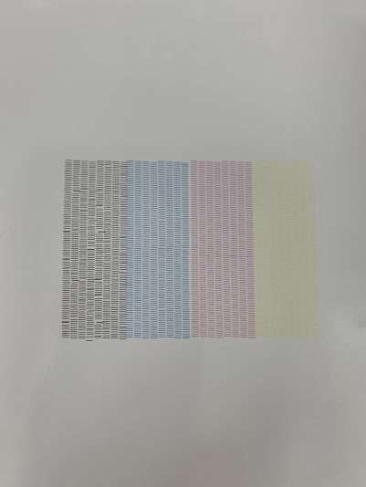

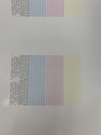

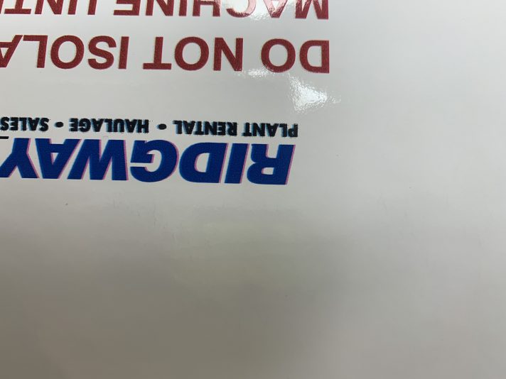

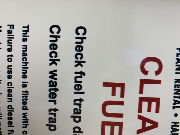

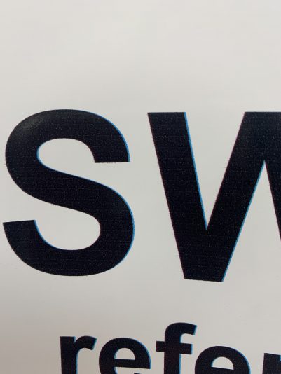

    Hi all so been on holiday for a week and come back to my printer having an issue. Ive attached a few pictures but not sure its clear. black text has a very very slight blue edge to it so on smaller text it looks blurry. I did a manual clean and then a test print, the black was a bit patchy so i ran a powerful clean and tested again. The black is worse now than before. Any ideas how to fix this jean

    However, all those wirey lines coming off the text, to me, is perhaps something else separate.
    I am not sure what machine you are using, but get access to look at the underside of the carriage to view your heads. shine a torch in, even if only a phone torch, you need a clear visual.
    Look for the finest of hairs, hanging from the edge of the head or on parts around the head.
    If you see one or more, remove them.
    If you see nothing, use a cleaning swab and fluid and clean around the head to make sure something is not there, even if you cannot see it. then print the same text and see how it looks.
    static can cause fine erratic whisps of ink to appear around text and graphics, but worse still, and more randomly is the likes of a thin hair hanging down and as the ink jets and the heads travel fast, you get these whispy lines all over the place.
    I am not saying this is the fix for the Cyan text shadow but it may help with the lines.

    Looks like a Roland test print to me, and the black head has quite a few deflections.
    You could try soaking the head in the cleaning solution, and whilst I know Roland don’t recommend it, get a swab soaked in cleaning solution and carefully wipe the nozzles.

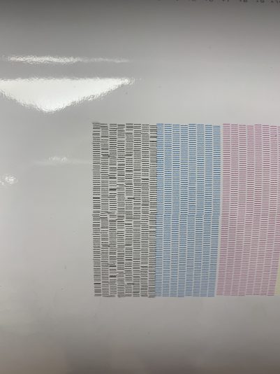

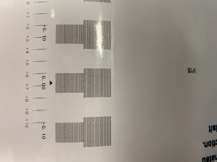

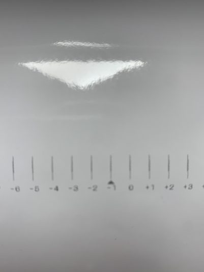

    Ok I’ve re checked for hairs and physically cleaned again. I’ve also done a few Normal cleans on the machine. attached is the calibration and other tests. I think the black is looking better but still far from great. I also changed printing to Uni direction from bi directional but it made no difference.
    Do you think the black deflections are related to the blue tinge on black text? also red tinge on blue text

    I have had Roland machines for 25 years now and the black print head is the issue here for sure I’m afraid. It looks like your printer is layering cyan magenta and yellow ink perfectly and ‘microscopically’ spraying the black everywhere.
    Have you any test prints from before you went away? I’d be very surprised if this was as a result of just a weeks absence to be honest.
    A head soak as David suggested would be my next move and almost relentless cleaning however. The one time we had such issues with a Roland Solvent printers it resulted in a new printhead I’m afraid.

    I can see how head soaks, cleaning etc may help with the print quality tests. But the ghost shadow of the text makes me think it’s something else.
    Have you had a head crash recently?
    This is maybe a bit random, but have you tried printing a different file, job or whatever, maybe even on a different material? I don’t think this will help with the misalignment, but may with the hairy prints if it’s static or whatever.

    On your initial post with photos, the one of the print head test shows the cyan head a bit to the left:
    the black & cyan appear to overlap slightly, then there’s a big bag between the cyan and magenta and a small gap between the magenta and yellow.
    Looks like the cyan edge to be a similar size to gap difference, so maybe the cyan head has moved a little?
    This is assuming all the heads are separate (not sure on your printer).
    Just a thought…

    So engineer Gary came out yesterday and fixed both problems. The black head unfortunately couldn’t be saved so was replaced and then the heads were all aligned correctly (they were way out). I’ve been printing solidly all day and its working as good as the day i got it. Thank you all for your words of wisdom and have a great weekend
