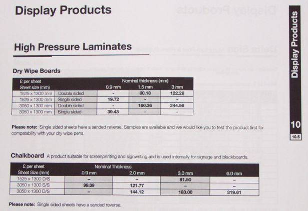

    Not really appropriate for this forum but needed to be able to upload images for you ref other postings…. These prices are only list costs and are obviously subject to negotiable discount 😉

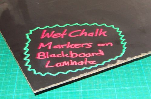

    I’ve been looking for wet chalk markers for a while, nice one 😀 But I’m puzzled, what is the benefit of buying the blackboard laminate? It must be a tad cheaper to paint some board, or foam??

    Yeah, it’s loads cheaper but I think you’ll find its quite tricky to make a good job of removing the wet chalk markers from black board painted surfaces, and you often have to repaint it to make it look respectable again. With the laminate material it is impervious to the chalk and most solvents too so you can wipe it clean and it looks as good as new.
    It’s very good stuff but obviously it’s not appropriate if you’re customer wants to spend 60 quid on a chalk “A” board !
    I have used it quite a bit for pub/bar menus and also in shops too and never had a problem with cleaning any type of chalk/markers off.

    Hadn’t thought about that 😕 Mind you, looking at those prices, nothing wrong with getting the .9mm and backing it with a bit of foam, or ext. mdf.. it’d still work out pretty cheap.

    I have done exactly what you suggest on occasions – I think roughly speaking I only pay about 60% of those costs aswell with a discount !
    The 0.9mm is single sided but you can easily bond it with some “no more nails” or contact adhesive to 3/8″ply or similar.
