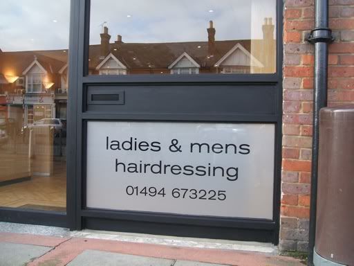

    They will read fine, did this today.
  • James Martin
    26 January 2009 at 15:35
    Nice one Warren.
    What kind of film did you use?
    This is metemark series4 (etched I think, I bought it a while back)
    Probably not the right look for a short term special offer but we wanted to see what it would look like?
    How did you get that picture up it wont let me embed?
  • Warren Beard
    26 January 2009 at 16:09
    Hi James
    I use Oracal window etch (8510), never used any others but find this really nice and always applied dry too 😉
    pm’ed you.
    cheers
