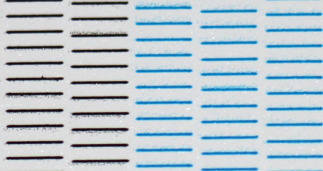

    Hoping someone can point me in right direction.
    Roland SP300V
    Last few days I’ve been getting what looks like overspray on black and cyan – I’ve been cleaning everything, head soaks, more cleaning… and the nozzle check looked ok – but when checked under lupe the cyan seems to be ‘overspraying / deflecting’ one way and the black the other way.
    Hope the image shows more clearly what I’m trying to explain..
    The Magenta and Yellow are fine.
    Does anyone have any ideas where I should look.
    Many thanks Nigel

    Hi,
    I would check that the mist sponge is clean as I had lots of overspray on the black with writing and couldn’t believe that it was just the sponge !!
    Hope that it is the same simple solution for you too !!
    Please let us all know what the solution was !
  • Nigel C
    14 July 2013 at 06:58
    Worn out printhead
    – New printhead and back to normal
  • Andrew Weaver
    14 July 2013 at 08:35
    🙁 Sorry about having to change the head but at least it’s up and running as it should be !
    Thanks for letteing us all know what the solution was !
