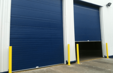

    I have a vinyl installation job in Birmingham that is required a.s.a.p.
    Basic numbers cut in yellow vinyl. (we will provide the numbers)
    Numbers only, 1 -to- 16.
    800mm High.
    Each number will be fitted to large up-and-over roller doors.
    The doors have large flat sections, not curved.
    the photo is “not” the actual doors, but will be in the sort of style of door.
    The baseline of the numbers should be fitted approximately 10ft from the ground.
    Full details, photos and spec will be provided prior to you committing.
