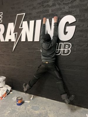

    We fitted some 10 and 20mm foamex letters inside a gym. Not overly big (see photo below) in the middle of January. Using the RP45 tape from signgeer. And it stuck. As it does.

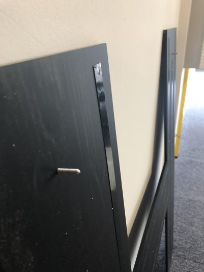

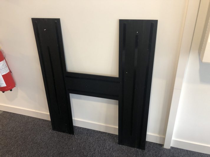

    However an N decided a few days later to hit the deck. So we replaced start of feb with a new letter, more RP45 (we basically flood coat the backs in this) and packed out any small indents in the wall with 3mm foamex to make sure all the letters had full bond. Clearly shown by photo. Which we thought was the problem.

    Chris, did Signgeer specifically tell you this tape would adhere to a brick wall?
    I can see your guy hanging there and I have no doubt this proves the letters were secure, at this point.
    However, I personally, would never have considered using any double-sided tape on that texture of wall, mate.

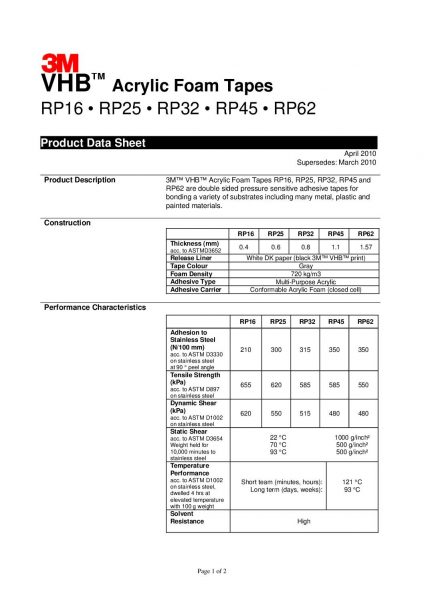

    Although tapes will bond to a variety of surfaces, if using the correct type, VHB in particular needs a very flat, clean surface to be able to build-up its bond.
    I would have insisted on using locators of some sort.

    The 2 studs on the top side of these letters were done for that reason, to support the 3M VHB
