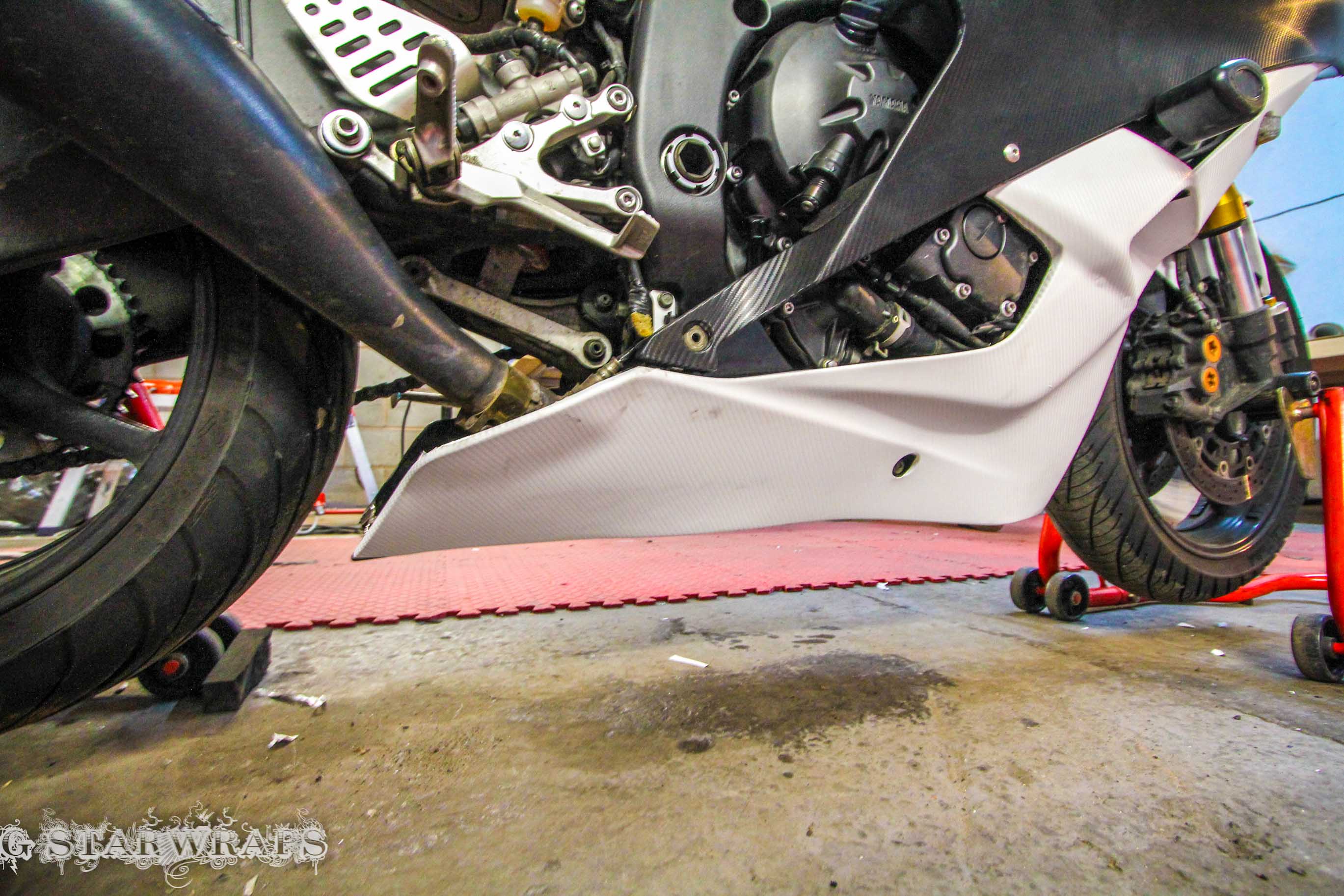

    in Picture 4 from top, you are showing signs of Blisters in the film in the corner of the deepest recess.

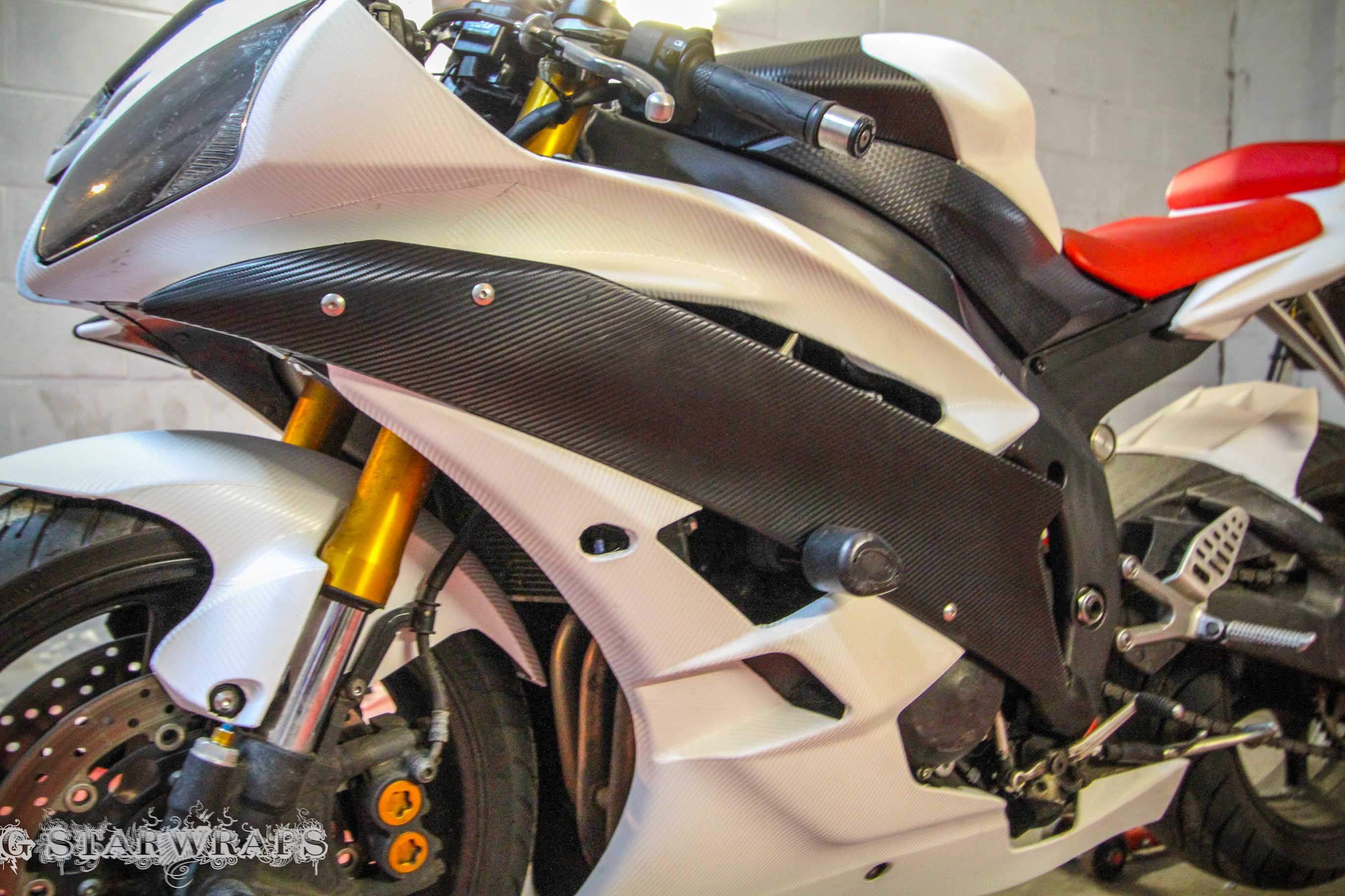

    in Picture 5 you are showing multiple joins on the white in the recesses below the handle bars. this should really have been wrapped in one piece, the front mud guard too. I am guessing the bike was not stripped down for you, but still.

    I did find the recesses very difficult, I really didnt think that the recess under the handle bars could have been done in one piece,
    just the other day I read your tutorial on very deep recesses, which i learned alot from,
    One think i did learn from doing this bike is, its sometime alot better getting the bits removed from the bike, lol
