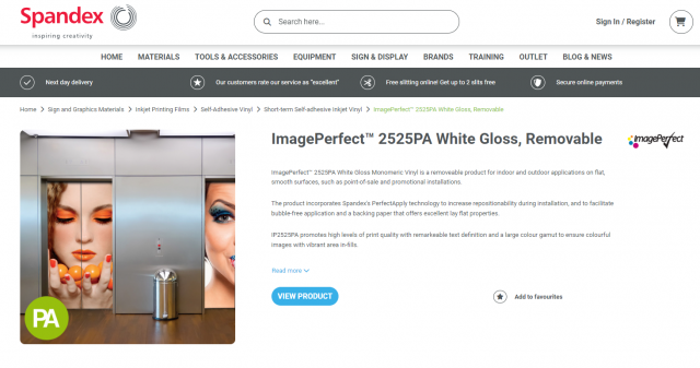

For short-term removable applications, I would suggest something like:
ImagePerfect™ 2525PA White Gloss, Removable -

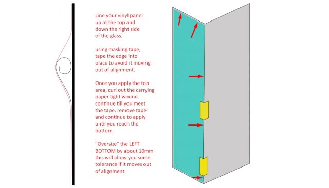

The vinyl comes with an air-release adhesive, so I definitely would not advise applying it wet, mate.
I agree, that the side windows will be difficult to apply, I can see that. But the glass will be cold/cool so
the initial bond won’t be great.
I am a strong advocate for “test running samples” Take an offcut of vinyl, cut it to size and actually test how you think you want to apply it. try it a couple of ways until you have a game plan in your head on how to approach it.
All too often over the years “I have” turned up on site only to struggle with printed jobs until I find my feet with how best to install it. when all I had to do was do a test run with some old bits of vinyl. -
If you use a regular polymeric vinyl and wet applied it, you are going to be there all day, trying to squeegee out the water and then trim it up if not aligned correctly. I think it would get messy and very time-consuming.
Do not get me wrong, wet applying vinyl is so easy to get the vinyl into place, nice and flat. but right there is where all the ease and help of wet application goes up in the air, and problems start.
