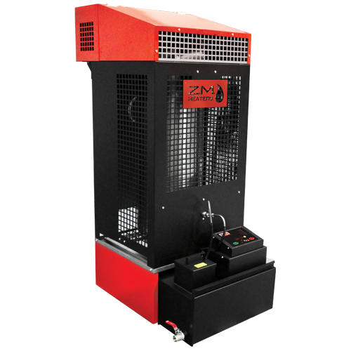

    1 March 2018 at 09:07
    Here’s our heater.
    Free standing, with a flue out the roof. :thumbsup:

    1 March 2018 at 10:15
    Nice bit of kit you have there David, i bet it also cost a pretty penny aswell tho. My fitting workshop does not need to be warm all the time only when needed.

    1 March 2018 at 11:23
    Thanks David that is the one I was looking at but cleaning out seemed to be a real chore and seemed to take about an hour before you got any real heat out of it, also does it have any smell?

    1 March 2018 at 15:06
    The garage over the way has a Hiton 145 heater, which in my opinion is much better, trouble is they’re hard to get hold of.
    The Hiton has fans behind it, giving more airflow out of the heater, thus quicker. I’m going to stick a fan behind ours just to disperse the heat quicker.
    It will take a bit of time to warm the unit up… as daft as it sounds it’s a different heat to the space heater we had. We can open the roller door up, and it doesn’t seem to loose the heat.
    Cleaning isn’t a massive issue, just knock the carbon out of the dish before relighting it. No fumes, or odour.
