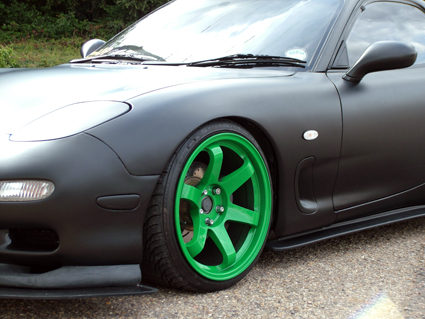

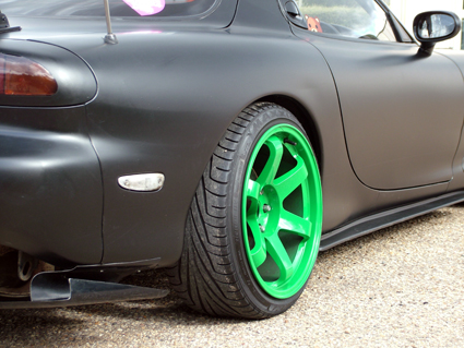

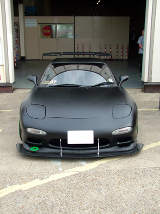

  • Daral Brennan
    20 April 2010 at 10:09
    Here’s some pics of 3M’s 85 series on a Mazda RX7. We did it for MAX POWER magazine.
