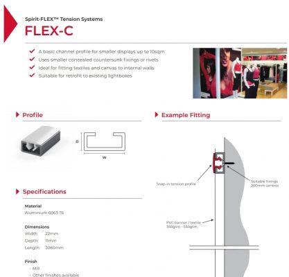

    The problem I have found is that unless the banners have a tension system like a bungee cord, the banner will sag and look loose.
    I prefer using something like the spirit flex tension system. keeps things very neat and tidy looking and in a way ensures the customer is coming back to you, for the repeat work then after.
    https://www.spirit-displays.com
