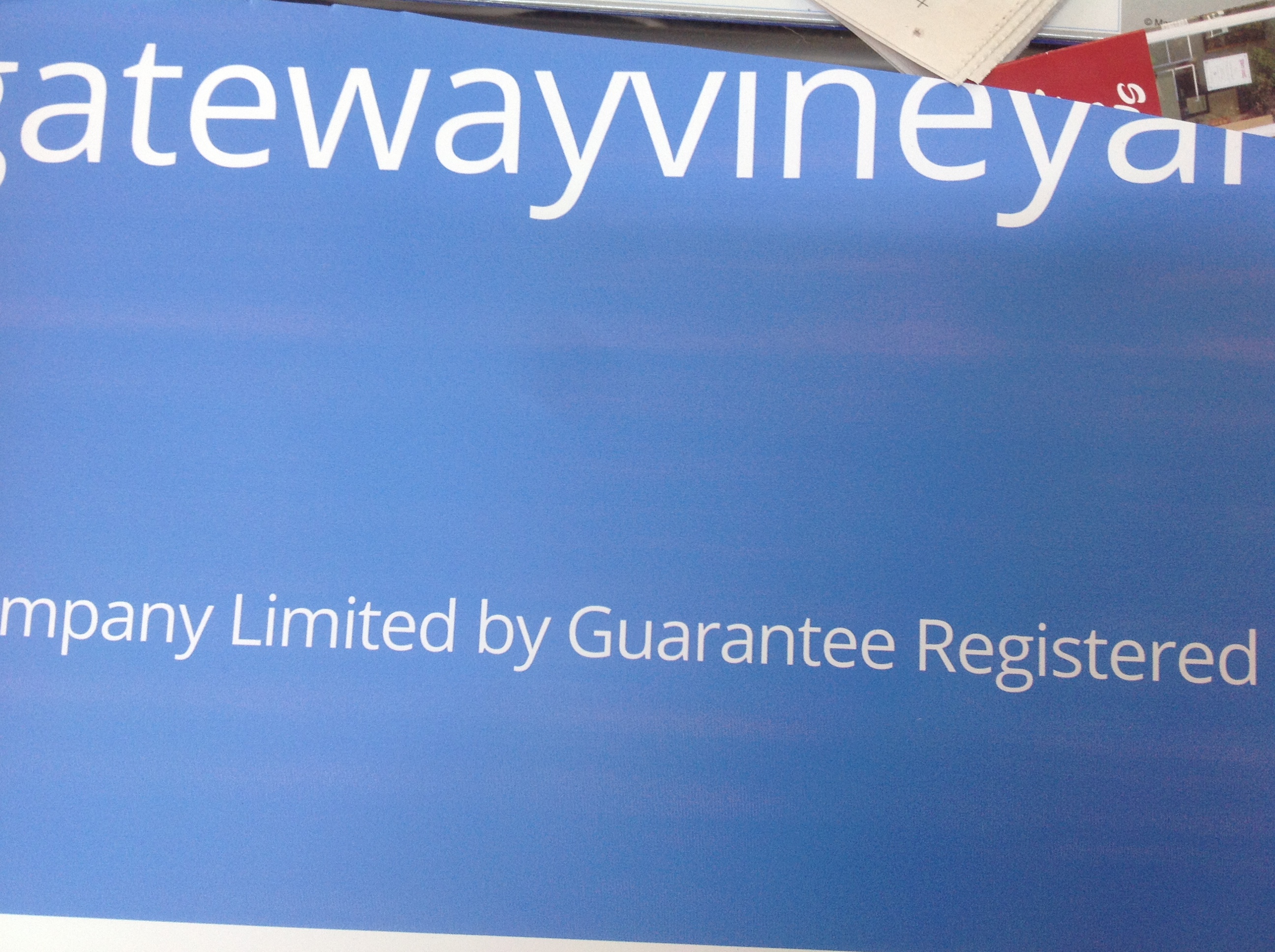

    It is weird, but when printing some lighter blues I am getting banding, where there is pink laid down underneath, but very little blue over, so I have blue prints with pink streaks!Test prints are fine. I have done the directional tests and adjusted accordingly, to no avail.
    It seems to happen when printing grey also, (but no pink).
    I’m beginning to wonder whether there is air getting in or something, but I don’t have a clue where to start, any advice welcome.
    I don’t know if you can see from the image.

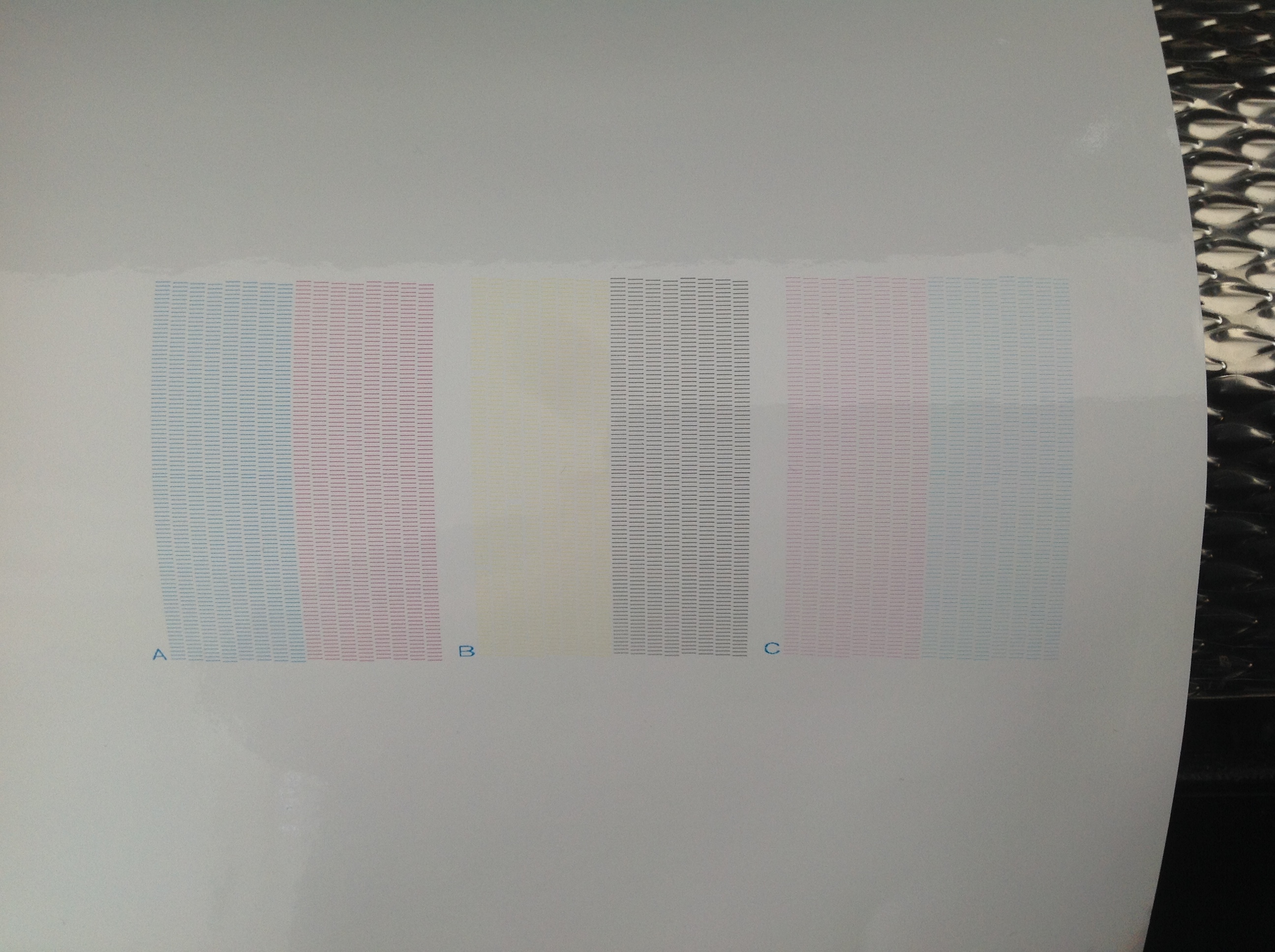

    What’s the test print like?
    I’d be thinking minor ink starvation issues as you’re getting ‘pink’ (lack of Magenta) / missing nozzles and about time for a damper change.
    dave

    David, the test print (nozzle check) is from yesterday, after running a couple of metres of print.
    Ink starvation would make sense, but would it not be on the cyan/light cyan, as this is the missing colour? I did a print yesterday with a dark blue, and although it wasn’t a solid block of colour I couldn’t see a problem with it. Confused…

    H Bob, i’m already using Metamark!
    It is a recent issue, which has increased in severity. It has happened on roll-up media too (also Metamark), in fact that was the photo I took.
    Printing multiple colours such as a photograph doesn’t have this issue, it is only solid colours. I still wonder if there is air ingress somewhere.

    I’ve seen this a few times on Mimaki JV3’s an it’s often to do with the slant adjustment. On a Roland it’s called a BIAS test. Are you able to post a picture of that? Also, have you tried feeding plenty of slack off the roll so the feed motor doesn’t have to snag the media do much? And finally, is the head assembly moving consistently? I.e, not pausing after every few passes?

    Hi Lorraine, often get this on our sp540, with solid colour blues and greys. Has it been very humid recently? We get banding when its very humid. we have changes all sorts of bits and then we found it it was humidity in the media, canvas can be really bad. I would try the same file and profile with a different material. Also has anyone asked you to check the left and right pinch rollers? We were told if they give a little it can cause banding.

    This type of banding is mechanical and is dependent upon a lot of factors such as temperature, humidity, media and a host of others. A normal fix is to simply put in 1 or 2 extra pinch rollers on the SP-540 instead of just using the left and right hand rollers and this should stop it happening.
