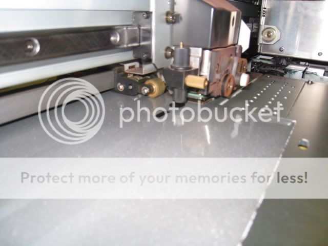

    When you first print complete with registration marks you must wind the vinyl forward before cutting it to leave 3 or 4 inches of vinyl behind the rear registration markers.
    This is so that once laminated, the vinyl can be fed back into the machine and will still cover the rear sensor when the the vinyl is wound forward far enough for the rear registration markers to be picked up by the sensor (if you do not leave enough margin behind the rear markers the vinyl will run out before being sensed).
    Here is a photo of the head position for picking up registration marker. Note it is not centred directly over the circle but is slightly in front (off centre)
