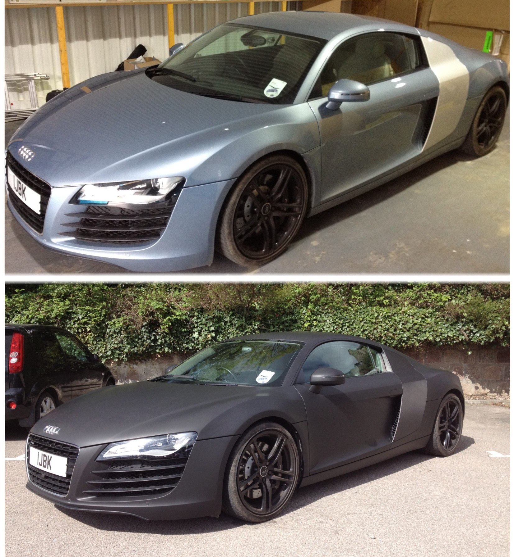

    Thanks for the advice guys, finally got round to doing the job and completed it this week.
    I’ll agree the R8 was a joy to wrap apart from the mirrors!! Customer loved it when he came to collect.
    This is only the second car i’ve wrapped since sitting the UKSB Wrap course last summer (my own car being the first) and the course really does fill you with confidence and knowledge to do the job right so a big thank you to Rob and James Deacon! 😀

    It was only the mirrors that needed to be removed Jon.
    24 May 2013 at 11:40
    well done stewart, looks great mate…
    thats a fair old jump into the deep end of wrapping doing a high end car like that on your first real live job. hats off to you for that…
    how did you find working with the Avery?
    thanks very much for taking the time to upload your work, always good to see how folk are moving forward after their training.

    Thanks Rob, Yeah it was a big jump into the deep end. It was a good customer of ours and he was understanding in the fact that i was still learning and wanted to improve so i was grateful to get the chance to do it.
    I love working with avery supreme! It’s such a good material to work with, i did my own car in the Pearlescent White and love the result of it, will have to upload some more of my work soon.
