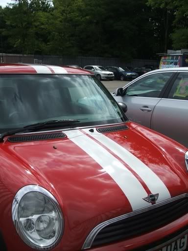

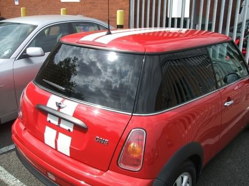

Well the kits were great actually and went on p1ss easy and only took 1.5 hours. All pre-cut, trimmed around badges and had cut lines for the ends of the roof.
very well put together kit.
Thanks for the tips all.
blimy, the kit doesnt even go over the bumpers! easy peeeezie.
:lol1: I know, and was happy to hear it too 😉 He initially told me it was a full kit from bumper to bumper but he was only guessing 😕 made my life easier and quicker to fit so a nice easy job for 9am Monday morning 😎
