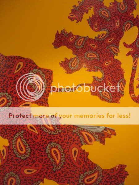

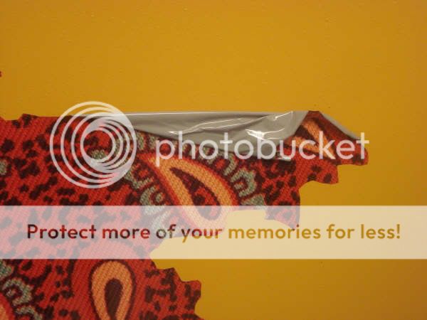

    3 May 2009 at 17:15
    Thanks for your replies guys.
    My daughter has since gone along and emailed me some pictures showing the extent of the problem.
    The size of the wall is 8ft high which should give you an indication of scale
    I am reluctant to now remove it as I now don’t think its as bad as I first thought. I am now hoping to trim away the curled section and replace it with a reprint of that part of the design.
    Whatcha think ?
    3 May 2009 at 17:19
    i remember alison telling me about this job in dundee phil, i would leave it on until the paint does dry, then heat the remainder into place? the thought of taking it all off and paint too, not a nice one 😕

    Hi Phil if that’s the only bit that has failed
    i would try and get that bit stuck down might just be something on the wall
    hope its the right way up

  • Harry Cleary
    3 May 2009 at 17:28
    Looks like it has a good chance to stick back down with a bit of heat. You may get away with it. 😀
  • John Singh
    3 May 2009 at 23:04
    I’d be inclined to coax as much back with a heat gun
    What can’t be salvaged trim back and print a new section to fit back

  • JasonA
    5 May 2009 at 09:38
    I would never apply vinyl to a freshly painted wall. I’m surprised you don’t have more lifting. Paint dries on the surface pretty quickly but the damp paint underneath will still be "Out-Gassing" for a week or two, until it is dry. I have found this out to my cost. For future reference, if it is emulsion, you can seal it with a watered down PVA mix. The vinyl will stick to this better.
    For now I’d go with what other people have suggested and use some heat to coax it back into place. If you try to remove the graphics, you will lift the paint.
