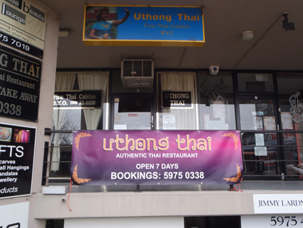

    Just looked on google maps and the shop faces the south east, so most exposure will be in the morning. From the photo shown in UKSB3.jpg, this was taken later in the day and I can still see partial exposure of the left window to direct light.

    The existing black and gold panel is fitted on the glass on inside of the restaurant. Not sure that makes a difference?

    Planning to put the vinyl on the exterior as the reflection on the glass does detract with the original black/gold sign. I’m pretty sure its toughened glass. Looks pretty thick. Like you say even if the old sign was on the inside, being black, its been ok and been there years. Will be nice to tie everything in as I made the banner for them also.
