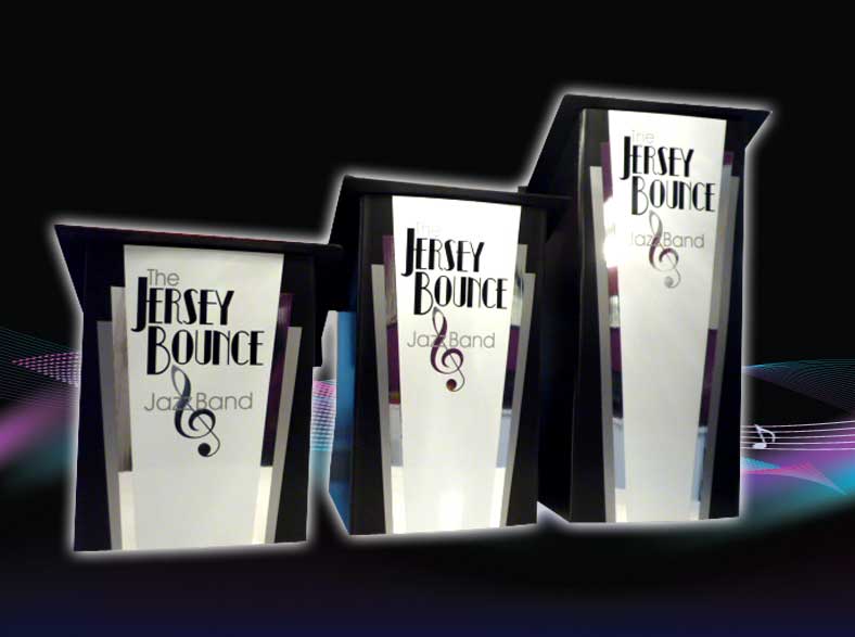

    I’ve just finished my first multi-vinyl job on 25 music stands and wanted to thank you for the help & advice you all gave me to get me to this point.
    Brilliant!
    Billy
  • John Singh
    1 December 2011 at 20:35
    Looks a very classy finish for Correx
  • Billy Lawton
    1 December 2011 at 22:51
    Hi John – it is 1250gsm fluted board (not actually Correx board – but very similar).
    Billy

  • Billy Lawton
    2 December 2011 at 14:20
    Hi Nicola,
    That’s the finished job – I cut out the outline in Photoshop and place it on my standard background so it looks nicer on the website.
    Otherwise they would see my workshop!! – not pretty most of the time!
    LOL

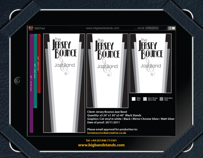

    The client gets a funky proof which I put together in Adobe InDesign & Photoshop from a photo of my iPad (attached)
    Billy
