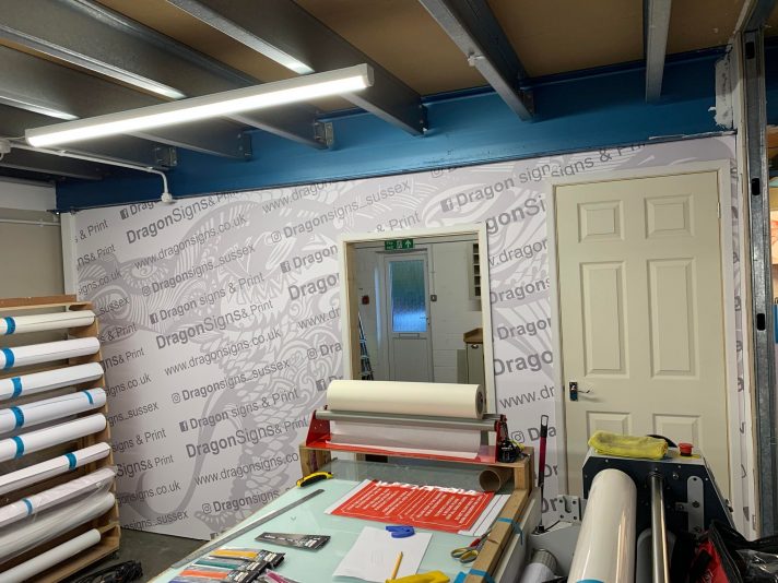

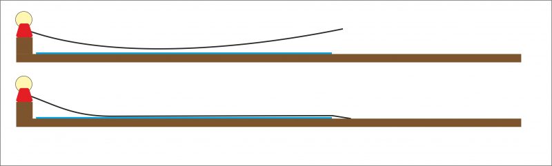

    My 610 dispenser sits raised on the end on an 800 wide glass topped bench – partly because I can’t screw it to glass! the bench is approx. 4m long. I can lay a cut vinyl on the bench, or extra long can run off the bench and under the dispenser.
    I roughly line the graphics up on the bench, with the dispenser. Pull out the app paper and keeping it in the air, allow it to sag and relax a moment, reducing tension, then lift slightly and lower the mid to rear section so it lays down on the print, keep it taught, just lay it along the length and onto your table… I then apply from the glass toward the dispenser. Don’t use to much tension or force it down to finish applying, try and lay it on.
    When I build me new 5.5 x 1.8m bench, I’ll be making a much larger version of this!

      You’re welcome, I find the extra height works well for me, it gives you a bit more leeway when aligning paper to vinyls, it also lets you drop excess material out over the end of the bench, once you do the first bit, pull it through and gently let it drop on to the vinyl before applying further. I’ve done around 10m in one stretch before now.
