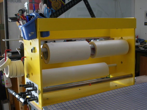

    Just about to upgrade, but been using 2 batons screwed to either side of the table with a 25mm wooden rod through the centre…..

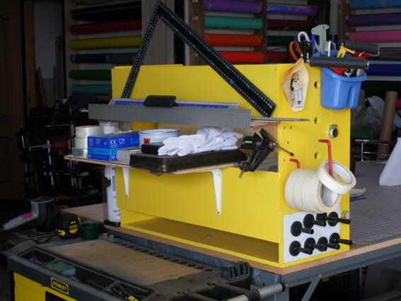

    I made one myself out of odd bits I had lying round the workshop, holds 2 rolls which is handy if like me you use both paper & clear tape. It lives at the end of the bench & has sort of sprouted other bits over time, various hooks a shelf I keep the rulers on & a plastic cutlery basket for knives, tweezers, pencils & few other odds & ends.
    Kind of hard to explain but you don’t really need someone to hold the app tape roll, if you lay the graphics on the bench, pull a foot or so off the roll & stick it to the bench & start of the graphics to be covered & then use something like a roll of vinyl to push the app tape roll along the bench.
