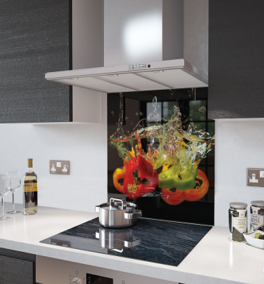

    5 October 2018 at 00:28
    These were the kind of thing i had in mind when you said splash back.
