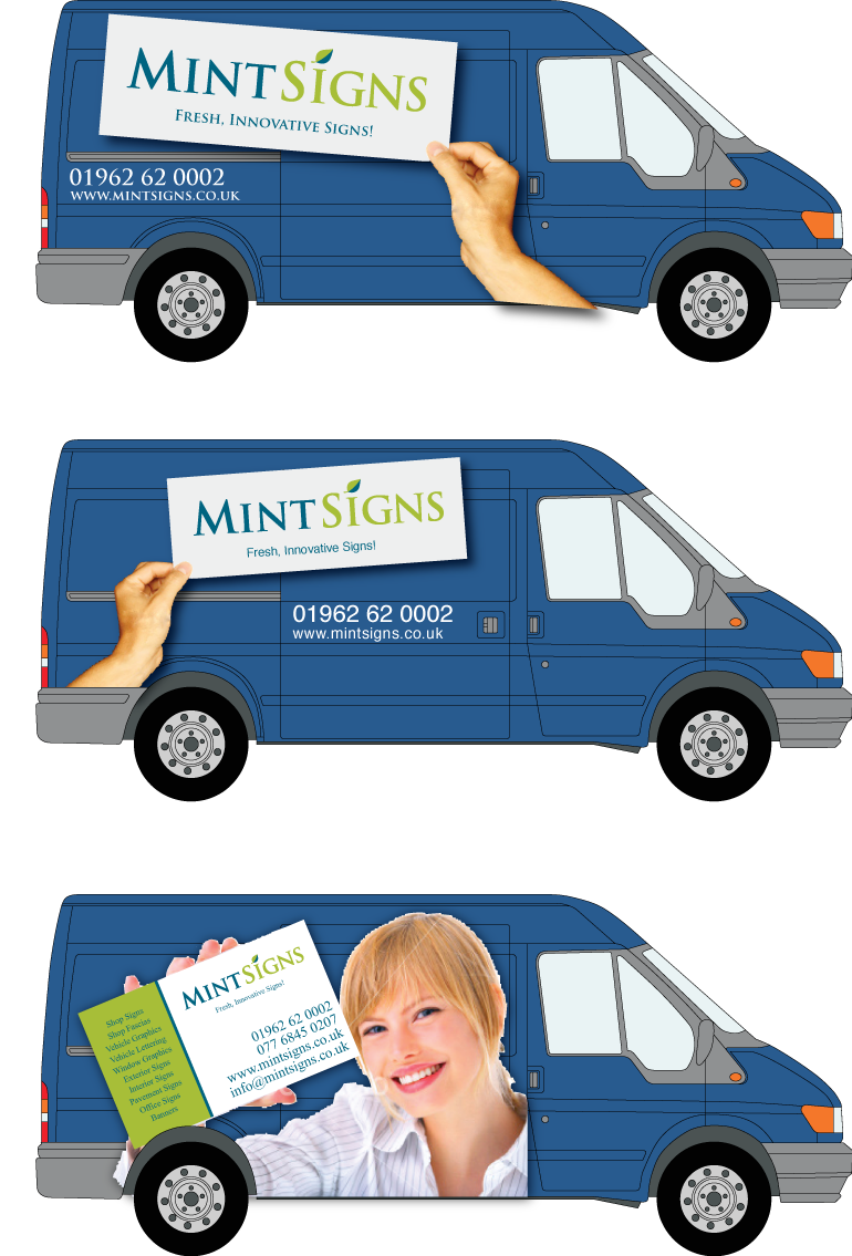

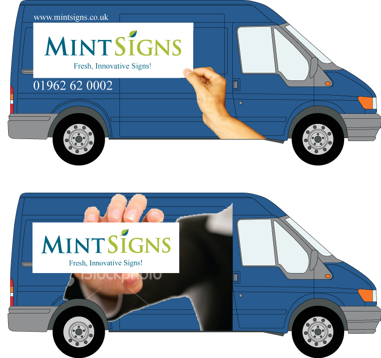

    Hi All
    Ding ding ding, ROUND 3 ( or 4 or 5 or something 🙄 )
    Due to the blue van and my colours I have a bit of a problem, so I thought best thing to do is turn it in to a part wrap with some digital image so people can see what I can do.
    I still want to keep it fairly simple and clean looking but need to create something where I can get my logo on to a white background as I have done here (these are still concept stage)
    Anybody out there got any good ideas for this or can help me tweak what I have done already. Will still need to see if these istock images will be good enough to print at this size.
    Anything goes really but remember I need to get the logo to stand out on the dark colour.
    Cheers and thanks
    Warren

  • Martin Cole
    20 December 2007 at 23:09
    Early stages Warren I know, but I like the idea, think I prefer the top one although the white looks a little to harsh.
    But at the mo can’t think of a more suitable colour to achieve the effect you want 😕
    Iv’e got to give it to you, you don’t let the grass grow under your feet, my van’s been blank for a good month now where it was stripped for new graphics 😕
  • Michael Potter
    20 December 2007 at 23:20
    Hi Warren
    I like the first one as well.
    Can you make the white slightly off white?
    Merry Christmas
    Mike 😀
  • Chris Wool
    20 December 2007 at 23:25
    yep took 4 mts to get something on mine, i also like the top idea,
    chris
    20 December 2007 at 23:26
    of the two, i prefer the top.
    the overall idea works well but the design needs more, not sure what at a glance. im not keen on the font used for the slogan, web address and the tell number. i think they should be in a sanserif font. those used sorta look a bit traditional against a modern logo/design. just my take on it…
    as i said, i think it needs more work but its a good start mate.
  • Andrew Boyle
    20 December 2007 at 23:51
    I like the idea …. it will show the cross section of the work you can do.
    I would have the top one, but have the white [hull white] going at an angle with the arm still bleeding off [this would show you could deal with full colour and recesses]
    I agree with Rob about the sub text and would have the white shape and arm towards the back and have the tel no. etc away from logo at the front maybe even doors in space 😀 😀
    cheers
    20 December 2007 at 23:52
    i really like the top design,
    as said, i think the white could perhaps be ‘less white’. and i’m not sure the tag line works too well.
    nice!
  • Steve Underhill
    20 December 2007 at 23:59
    First thing I would do is take the "istockphoto" watermark off the van. :lol1:
    Good idea though, i like the top one too.
  • Andy Gorman
    21 December 2007 at 00:42
    I like the idea, especially the top one.
    Maybe you could photograph your own hand holding your business card, so the whole thing is photographic, and with a bit of perspective. The perfect rectangle isn’t very dynamic.
  • Duncan Wilkie
    21 December 2007 at 02:39
    I like #2. I think you could make the "card" out of 4mm dibond and stand it off the van with spacers. Also I’d like to see lettering cut out of 1/2" PVC and bonded onto the Dibond backer. The mint leaf could be carved to a 3D shape. If the van is on the highway a lot, you’d have to anchor it down very well. 🙂 or make it removable with a vinyl image behind it on the van for highway speeds.
    Maybe tilt the card a bit to break the symmetry, it’s kind of "stiff".
    I think it’s a neat concept either way Warren.
    Cheers mate!
  • Glenn Sharp
    21 December 2007 at 07:52
    top one for me too……………..I know you’ve probably tried to keep the card as clean looking as possible but I think I would try & get the telephone number & website incorporated into it rather than outside of it
    A dropped shadow wouldn’t go amiss to give it a bit of depth
    I reckon it’ll look really effective once you’ve got it sorted
  • Warren Beard
    21 December 2007 at 08:55
    Hi all and thanks for the responses.
    Some good ideas and opinions, I will try a few more options and post some more.
    I was also thinking of making the white box a banner with the hand pulling it out of a roll up type mechanism. I will have to see what I can source picture wise that will be good enough to print at that size.
    I am also trying to keep the wrapping element of the design as little as possible as it is something I have never even attempted before.
    Be back soon 😉
    Warren
    21 December 2007 at 10:15
    I agree with bits and pieces of what most have already said.
    the white rectangle would be better at an angle and I also think it would be best with the number and website within that too.

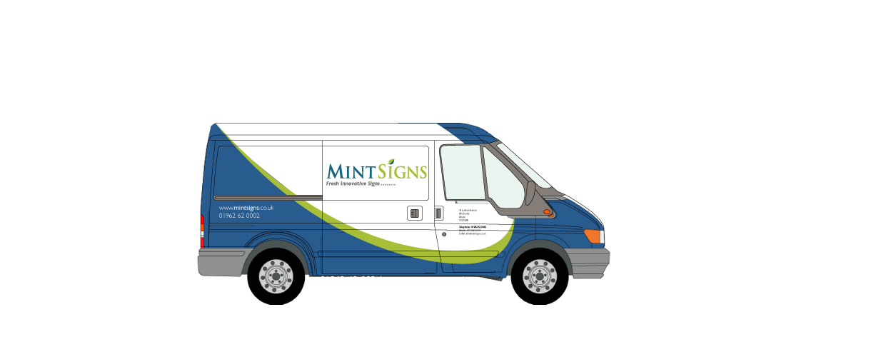

  • Warren Beard
    21 December 2007 at 10:20
    Hi All
    Just thought I would post this to see if I am in the right direction.
    The bottom one is similar to my business card.
    I’m not sure how the drop shadow will be printed to let the blue through to create the fade effect of the shadow, will it have to be a hard solid line for the shadow?
    Different fonts as well.
    Warren

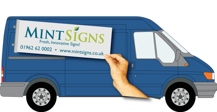

  • Warren Beard
    21 December 2007 at 10:41
    and the one with the banner mechanism and I put the tel and web inside the "banner"

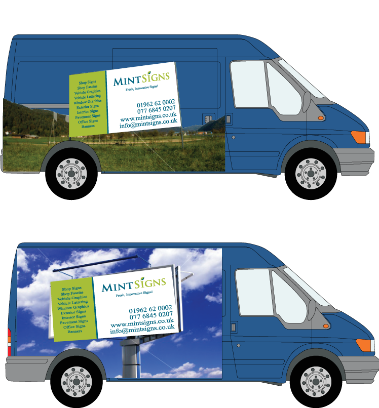

  • Warren Beard
    21 December 2007 at 10:53
    another option 🙄

    The pop up looks like a good idea Warren, but how about fixing a real pop up cassette to the side of the van? A small Piece of material coming out and merging with the vinyl.?
    I would be careful with any cast/faded shadows as they would not work on a dark colour van (needs to be printed on clear to merge with the background,) unless you go foe a complete wrap….
    Also stay clear of any detail and text passing over the door runners

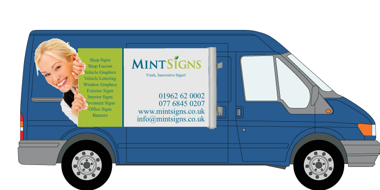

  • Warren Beard
    21 December 2007 at 13:06
    This was the other thought I had but don’t think it’s as good as the others.
    They are very quick mock ups so don’t fit exact. The image would also be extended to the front of the cab.

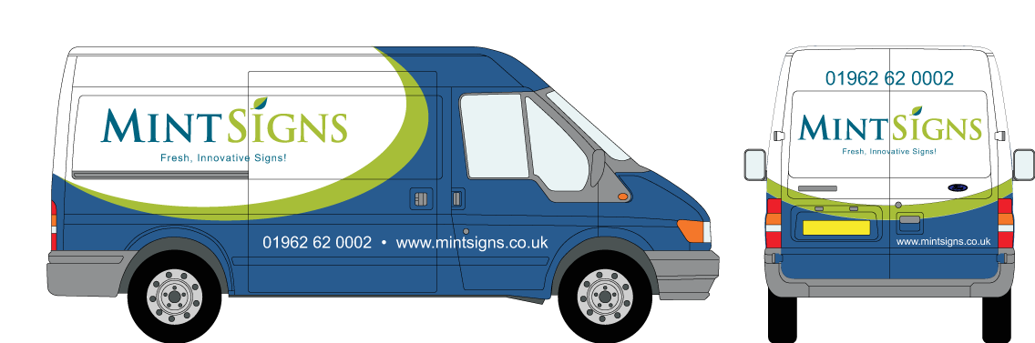

  • Warren Beard
    21 December 2007 at 19:59
    Thanks Chris, I am just throwing these together quickly and not spending too much time on each, as soon as I know I am on the right track I will start tweaking it.
    My latest thoughts but has no digi printing 😉
    Warren
    21 December 2007 at 20:07
    the last design is better
  • Ade Brown
    21 December 2007 at 20:38
    I like the last one too!!
  • Andrew Boyle
    21 December 2007 at 20:47
    looking good Warren…….I would have your tagline ranged left maybe italic semibold it will be fine ranged left as the leaf is on the right [grey text?] top right/bottom left]]
    the other text maybe try the word mintsigns as part of the web address in bold and the replace the dot with a slash or a dash….don’t know I have been wrong a lot at work recently :lol1: :lol1:
    21 December 2007 at 20:51
    :lol1: :lol1: warren that last one is very close to one of my designs i have for our vans. our company colours are also blue and green. its not exact same but the overall look is very similar… :lol1: :lol1: :lol1:
    21 December 2007 at 21:06
    i do like the last one warren…even though im not a fan of swooshes, i would drop the large telephone number on the back door it spoils it 😀
    21 December 2007 at 21:19
    that’s nice Warren like that 😀
  • Neil Speirs
    22 December 2007 at 01:35
    Wow, the last one looks the dogs dangilies :thumbsup:
  • Andrew Boyle

  • Warren Beard
    22 December 2007 at 15:07
    With regards to the design above, would the oval be cut in to pieces cut horizontally? As this cannot fit through a cutter in 1 piece (as far as I know) I would have to get it cut in to pieces and then fit piece by piece!
    An I correct and do you have any tips? 🙄
    Warren[/i]
    22 December 2007 at 17:49
    Warren your oval could be cut on a 1300 plotter, Andrews would be a tad big, but not an issue to cut by hand.
    Just use a good cast or wrapping vinyl, and although do-able in one piece, may be easier to join at the bottom of the top panel. It’s going to be in several pieces anyway on the door side
