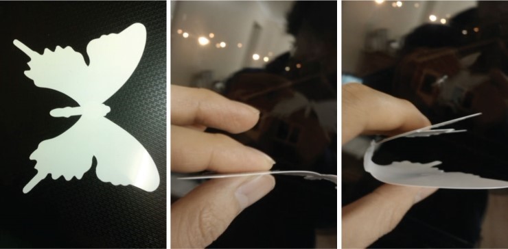

    hi
    as showing on the photo.
    it is very thin plastic sheet ,
    how do you call it and when we can get it?
    i guess it cut by Silhouette Cameo.
    can it be cut by normal cutter like ce-5000?
    any ideas welcome!!!
    thanks

    sorry dont know what its called, but try rober horne.
  • Harry Cleary
    26 October 2012 at 08:03
    I think that is what is called HIPS plastic. Used for the safety sign business. Never used it myself so could be wrong.
    26 October 2012 at 08:24
    440 or 220 micron Stauffen semi rigid PVC?
    I’ve used that on some POS boards.
    It can be cut on a plotter, we used a FC8000, Red top blade, and make sure the blade is in the right position so not to damage your cutting strip.
    Watch the pinch rollers though, as once they are cut out, the pinch rollers will snag in the void. We just scoured the outline of the board, but cut the slots for each product rail.
