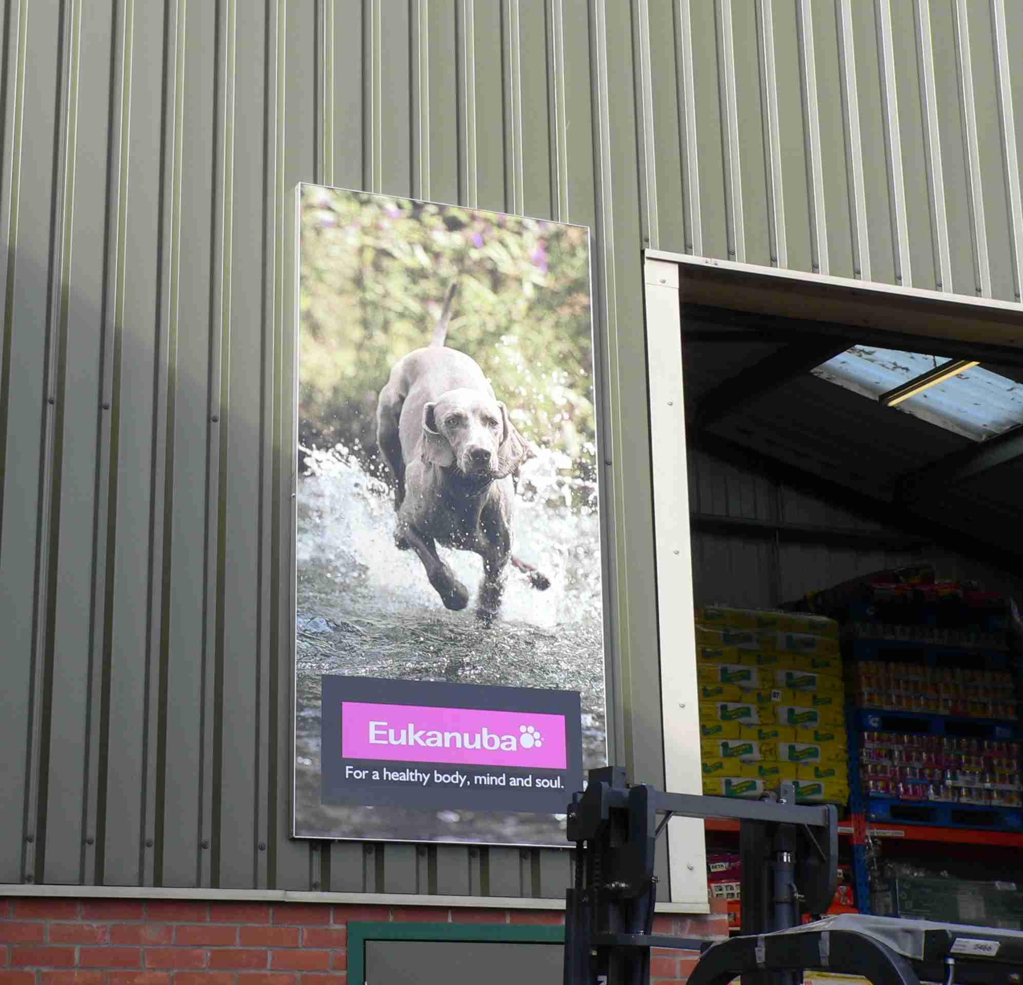

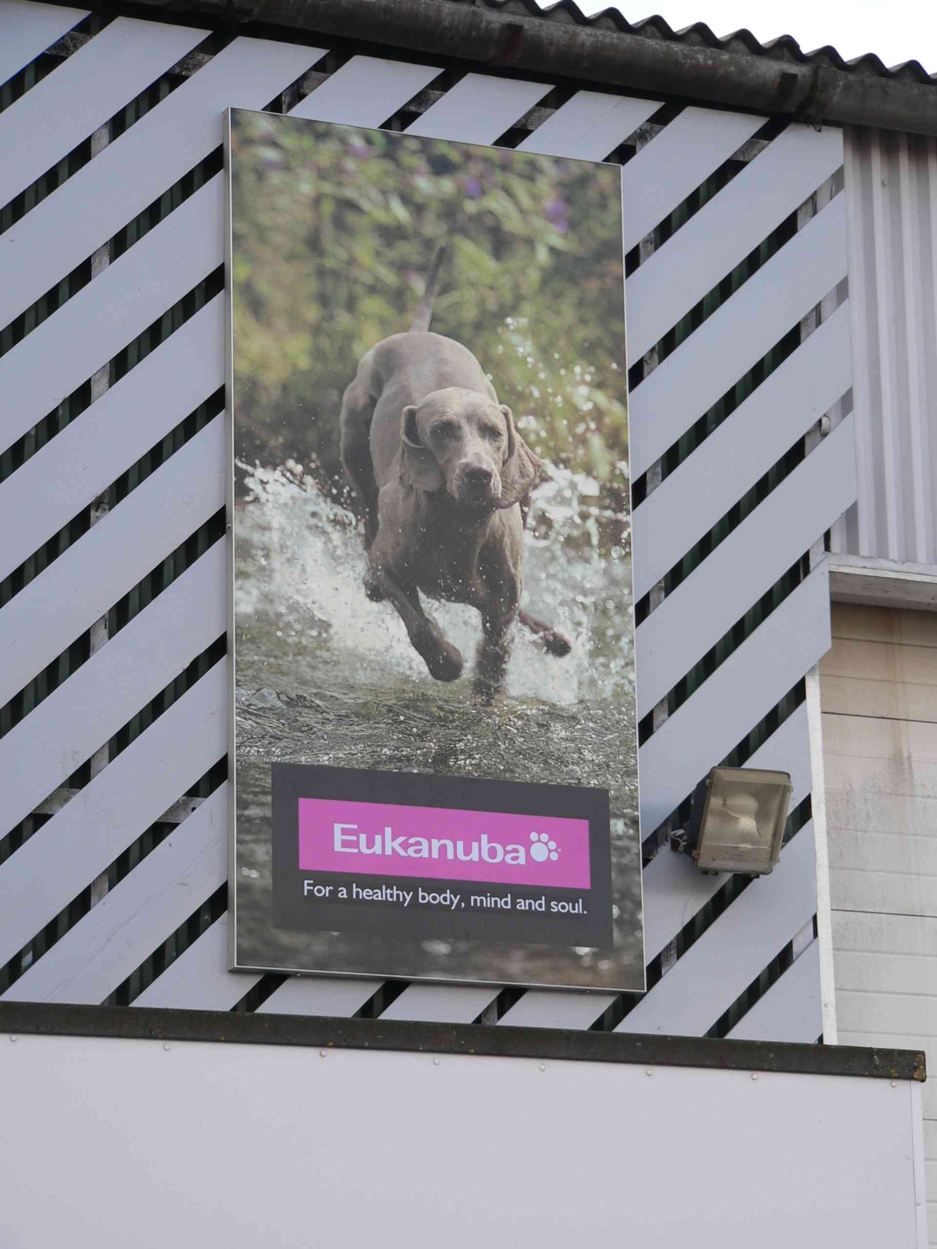

    Fitted these 2 today. Returns done with SMP extrusion
    We only did the eukanuba signs, (thanks to John Simpson for the prints)

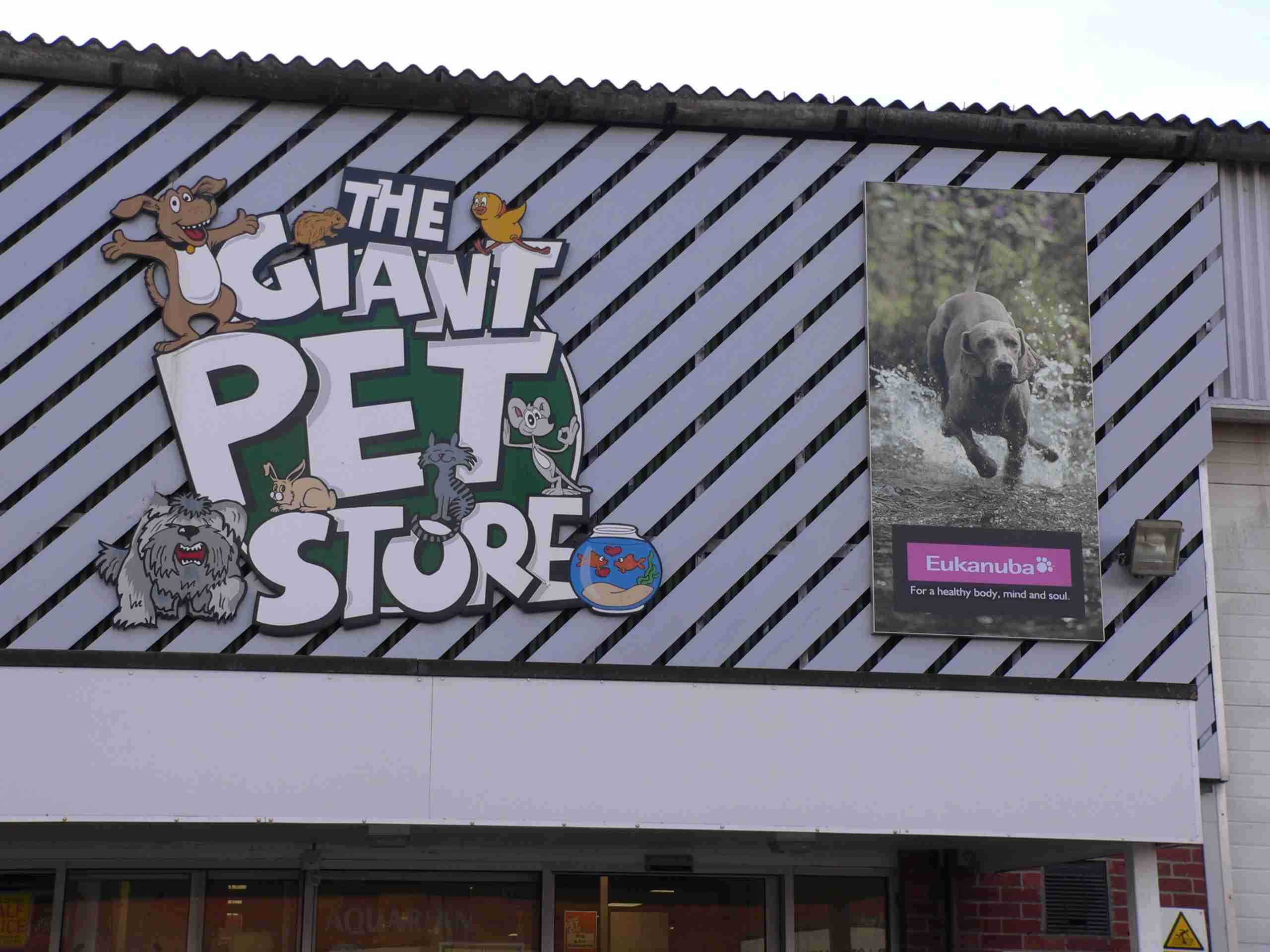

    but I did like the Giant Pet store sign, which was already at one of the locations
    Both signs 8′ x 4′ Arms are acheing after fitting on my own

    Jon,
    As far as fixings go, the trays are hung using 4 pieces of ali angle. On the clad building, I used pop rivets to fix the angle. 2 full width pieces top and bottom, and 2 pieces of about 2′ for the centre of the sides.
    I then used self drill and tap bolts to fix the tray to the angles.
    The Giant Pet Store had a wooden fascia, so screws instead of rivets.
    I sometimes use the self drills to fix direct to the cladding, but in this case because the sign was hung portrait, felt rivets were safer (2 on each corner of the highs on the cladding)

    The print was laminated, but John no doubt wil tell you more.
    Its no great fete to fit single handed, the alucolour is very light, it might have been a bit awkward in any wind though.
