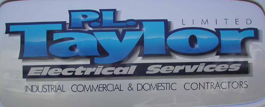

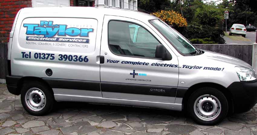

    A revamped logo I produced after my customer changed his vans from dark blue to silver
    Airbrushed vinyls on Berlingo-
    sprayed onto silver vinyl for the drop shadow

    That drop shadow is brilliant mate had me thinking for a couple of minutes (till I re read your post properly that is 😆 )
    24 June 2004 at 10:55
    Terry,
    The layout on this job is perfect.
    It is so “punchy”, clean and balanced.
    You do outstanding work.
    I’ll bet you had fun doing it too!
    Love…Jill
    (punchy means it’s snappy & attention getting!) 😉

    These are stunning who needs a digital printer
    Regards Brian

    Nice work Terry!
    But I think Jill got a bit too close when you were spraying as she has got a load of overspray in her hair!
    24 June 2004 at 20:53
    excellent effect mate.. top class as ever! 😉
    how long would something like this take you?

    Rob , airbrushing the vinyls takes only about 30min
    Theyre done prior to laying up and the shadow is cut into pieces to align more accuratly and butted against the major shapes
    inks used ,the blue text gets a brushed clearcoat for extra protection
    though ive not had inks fail

    Nice work as usual terry. Exactly what inks do you use? I use createx auto air but its a sod going through the brush at times.

    Not sure I understood the shadow bit
    You say you cut individually then butt to the major parts
    Is there chance of shrinkage – leaving a gap
    Or do you overlap slightly
    Curious
  • Terry Bull
    27 June 2004 at 23:16
    Paul
    The inks are regular vinyl printing inks, some being Softside (for lettering truck curtains ) from Keeps that ive had for many years and some that was given to me by a printer friend
    Yes thats right I butt up against not overlap cause I like to leave the design as flat as possible ,using mac 9800 ive not had any shrinkage to date
    Another reason for butting originally was that if the airbrushing failed then it would be quite simple to redo and replace,though this has not been needed
