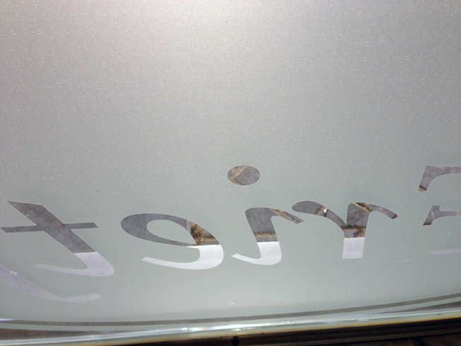

Has anyone of you people had a look at an air release etch with sun shining on it…
I do and It looks awfull, you can see the pattern in wich the glue is laid out on the surface…I will take a picture next week and post this on this forum.
(Vinyl is applied on inside, needs to been seen for people walking outside)
Have to say first time I tried it when it came out over a year ago it was shocking. Used app tape and applied inside windows and was as Tim says all streaky. Ripped off and replaced with normal and all ok.

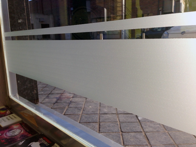

I used the Hexis air release on the inside and it looked absolutely fine from the outside.
Alan D -

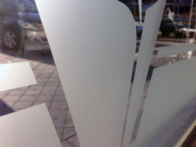

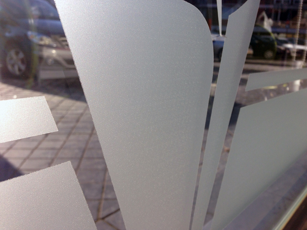

Hi Stuart, cut vinyl had app tape but large strip was straight from roll. Used a Teflon squeegee which glides better. Must say I got to the end and put a kink in the etch, went to van and got heat gun out and disappeared without a trace too
Have to say that is bad, no wonder you are not impressed. Had a similar problem with a certain make but the metamark one was ok.
Worth getting a sample to try

The Hexis stuff I used was nothing like that. You could not tell the difference between air release and conventional material once applied, it did have a high initial grab though. I was putting on some pieces 1800mm X 570mm without a hint of a bubble I’m not sure I could say the same with ordinary material especially as there was limited space behind the window which made application awkward.
Alan D -

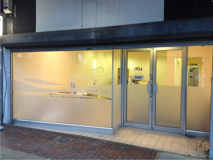

That does look a bad finish. But not the air release grid pattern I would have expected. Looks like a load of dust.
Would be interesting to know their installation procedures.
Also what etch is it? -
I know its not dust just saying the effect looks like it.
What brand ? so we know what to avoid. -
Yes do say what brand. Hexis stuff is good but I thought a bit expensive. I’ve just had some material in from Victory (sample) which has the distinctive air release adhesive pattern and that also seems fine once applied to a window and is cheaper but has to be ordered in.
Alan D -
Tim said it wasn’t one of his jobs so he probably doesn’t know what brand of vinyl it is.
