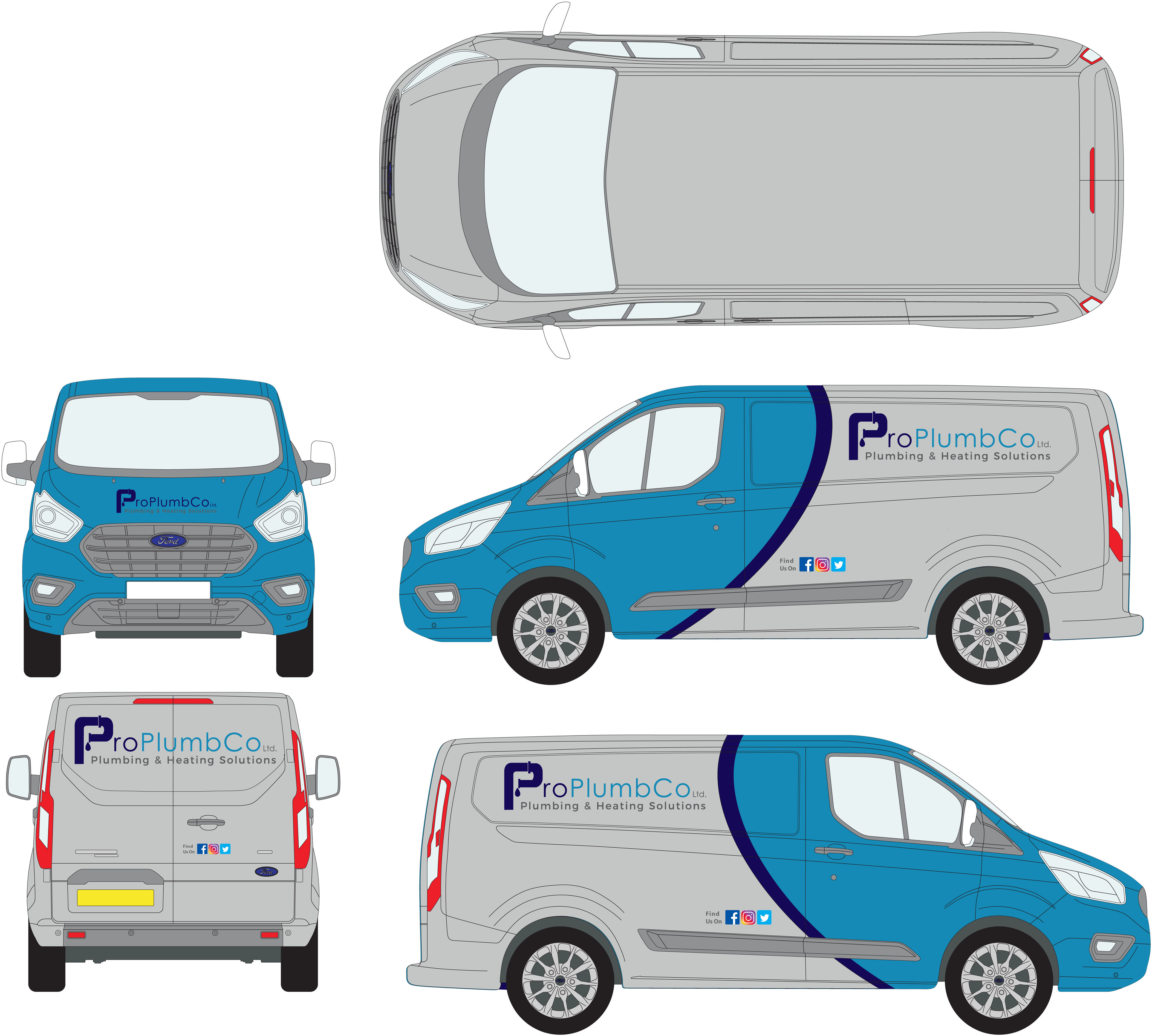

    Hi Guys,
    I’ve been putting off wrapping for as long as I can but I’m getting inundated with these kinds of jobs and it’s silly to keep turning down good work.
    This is an ongoing proof for a customer of mine. Initially, he wanted a blue chrome wrap on the front of the van. As with most jobs, the customers aren’t aware of the price of executing a job like this and no surprise it was too much for his budget. He’s said his maximum budget is a grand and he’d like something eye-catching.
    Could anyone make some suggestions on how I could make this affordable for the client and also fill the brief, please?
    James

    What colour is the van at the moment James?
  • James Boden
    3 September 2018 at 16:05
    Hi David,
    It’s silver

    Regardless of the material, there’s some time involved there.
    Removing handles, and any other bits you’d rather weren’t there. Then any you do keep in place theres the trimming round, tucking into, round the windows on the doors, if it’s a colour coded bumper the fog lights. Cleaning & surface prep too.
    Guessing 1-2 days, just depends if you can just get on with it, or if you get interrupted like we do, and how proficient you are at stripping & fitting.
    Materials guessing 10m @ £25 a meter (depends on what you use and price you pay) there’s £250, in materials alone.
    Your wrapping the most difficult & fiddly bits of the whole van. So I’d like 1100-1200+VAT for that… probably never get it.
    Always ask the budget before you start the design 😉 explain why you’re asking, (prime example) or at the minimum give a between £x & £y price and take a deposit before you start designing.

    Could you turn it around and wrap the back instead? Like David said the front is the most difficult and fiddly. Back section would be much more straight forward provided you didn’t have to wrap the bumper. Also leave the roof if possible, will save him a couple of m2 of material and you some time. You could wrap the back back 300mm or so of the roof but put a curve in it so it looks like it was done on purpose.
  • David Stevenson
    3 September 2018 at 18:40
    Oracal 979ra is a good material and about £20 a metre

    As David says turn the design around and wrap the back instead, much easier and within their budget

    I’ve just done a DAF cab for a regular customer, if it’d been a new customer I’d have said no but this customer isn’t expecting perfection, and he wasn’t going to get it on a 10 year old truck, but he wanted a colour change.
    3 days with fitting a few smaller jobs in the middle. Trims, handles, mirrors etc all came off and that was a simple job, I’d imagine the front of a van would be far more complicated and to do that and the rest of the sign writing on a grand is impossible.
    As said, doing the back would be a far better option or as Phil said stick to cut vinyl.
