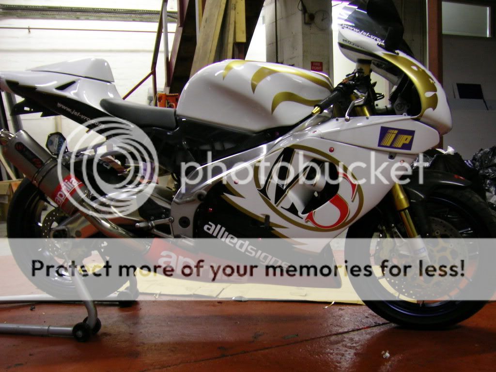

    easy that one mate, we do about 3 bikes a month, simple that design, why dont you put the stripes on??
    Some shapes distort with the bikes shape & you may end up cutting to shape on the bike, make templates in paper then reproduce in vinyl, takes a bit of time, not worth the money but if your into bikes, your into bikes..not sure how to add an image or i would..[/img]

  • Phil Veitch
    4 November 2008 at 10:07
    NOT AS HARD AS YOU THINK…GOOD LUCK[/img]
