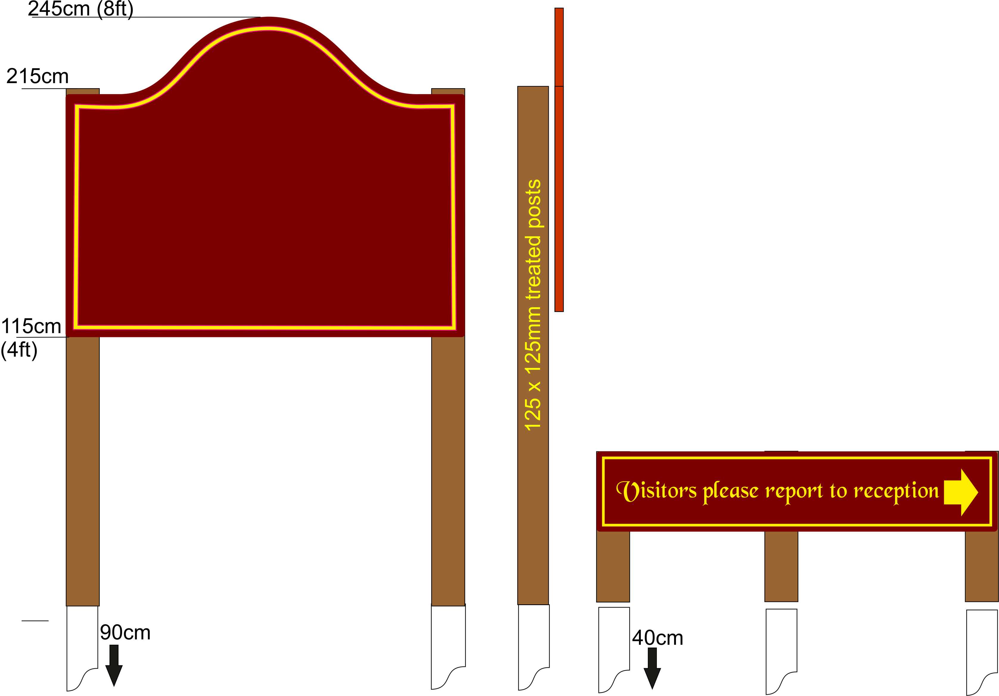

Posted by Hugh Potter on 1 May 2012 at 10:46Hi Guys n Gals,
I’ve had a quick search but can’t find what I know is on here somewhere!
I have this job to install this week, I intend to go and put the posts in tomorrow am and then the signs on thursday, I just have a couple of questions…
.. the scales are on the image attached.
1), is 900mm deep / concreted / 2 posts enough to safely hold this sign in place? going into fairly firm ground.
2) do I need to concrete the smaller one in place or just pack the soil back in tight?
It’s in the grounds of a primary school so despite radius corners I’ve put the posts to the edge of the sign, should I have a 3rd post in there – really? posts are damned strong and very heavy!

900mm under ground would be fiine I would think…rule of thumb is a third underground
I would also use concrete on the smaller sign,
Third post could be over kill depends how wide the sign is and what panel is msde of,
.happy digging
cheers Martin,
the signs are both 3mm powder coated aluminium. My concern with the smaller one is that kids might sit or lean on the thing, being on 300mm tall it’ll most likely bend, hence – unfortunately, the third post! I might buy a 100×100 for that one as 125 x is a bit overkill!
Hugh

I would put a third post in then Hugh, but make them all the same size, it would look better.
do you mean a third post for the big one or as i’ve done on the little one?
do have a spare post if I need it. don’t want to overkill too much though!
Hugh

Little sign Hugh.
If it’s a concern that the sign might be sat on kicked etc, then a third would be a good idea, but make them the same size ie, 3 x 125mm. -
If you put three posts in then set the two outside ones tomorrow, dig the hole for the third but concrete it in after you have fitted the sign. That way you won’t get in a muddle if one of the posts moves slightly.
that’s what I thought ya meant, though when I said might use 100mm posts I meant all three on it, may as well use the big’uns now I got them!
Hugh you could of run a nice capping piece along the top of the smaller one
with a bevel edge all round if you are concerned about it being sat on, stood on etc etc. -

I wouldn’t put the posts right tight to the outside of the panel unless fully constructed and lowering into the hole in one go.
your going to leave yourself side open to the poles being out slightly other wise.come in at least a foot from either end of the sign.
rounding the corners of your panel can easily be done with a jigsaw with metal cutting blade and a file.the depths you have are about right, but as martin says use concrete on both small and large sign.

The sign was made / powder coated with radius corners but, being only 4ft from the ground and next to one of the footpaths, I’m concerned about kids bangin heads, even a radius corner can do some damage to a kid running into it with his forehead! I can’t go back further from the path as the chainlink fence is only a foot or so back.
re fitting the posts, my intention was to screw 4×1 across the faces to hold the posts in place while setting, I was more concerned about wind affecting it while setting – even if braced, though due to time this may be my option now.

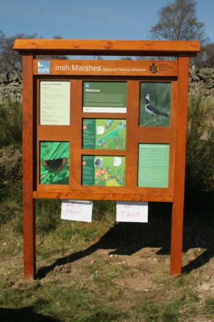

Bit late for advice but out of interest here is a frame I installed yesterday. Although the RSPB only specify the posts be in the ground 600mm I put them in 900mm with 2 bags of postcrete each. The recommended timber to be used is oak but these posts are Larch which is good for underground use as well. Doug
