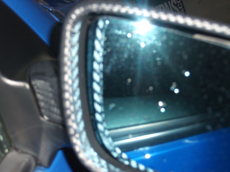

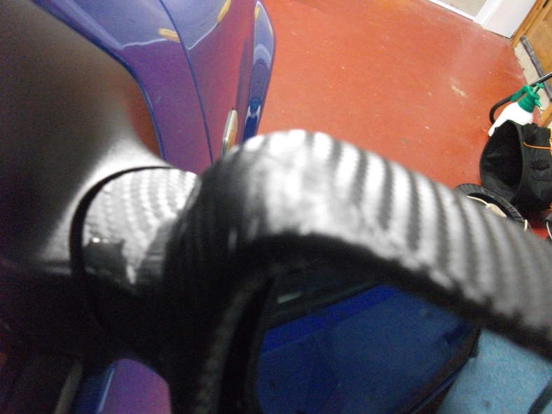

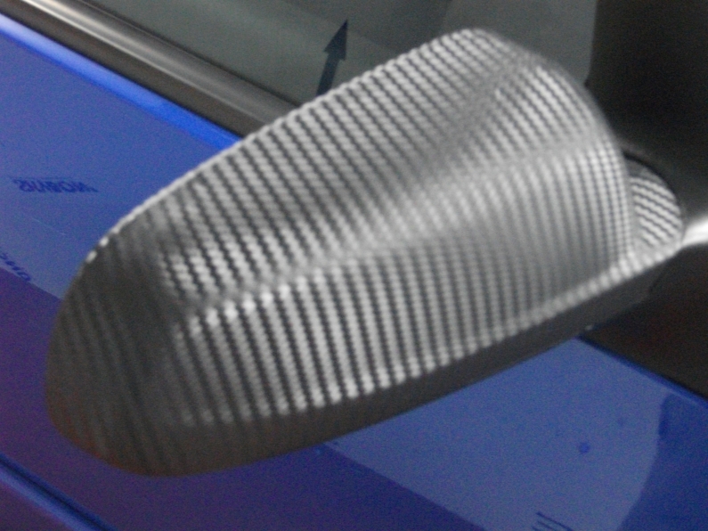

    I done a mirror as a trial. Ill post a picture later. the outside applied no problem but on the return inside the mirror the vinyl bunches up and causes a few creases. Anyone wrapped these mirrors before?? the customer thinks its grand but am not happy with it as its a bad reflection on me. any help would be great.

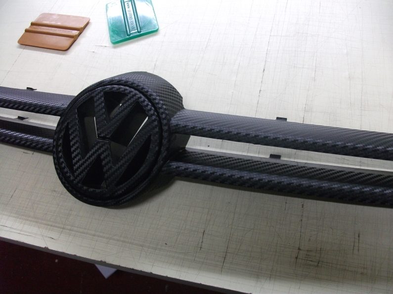

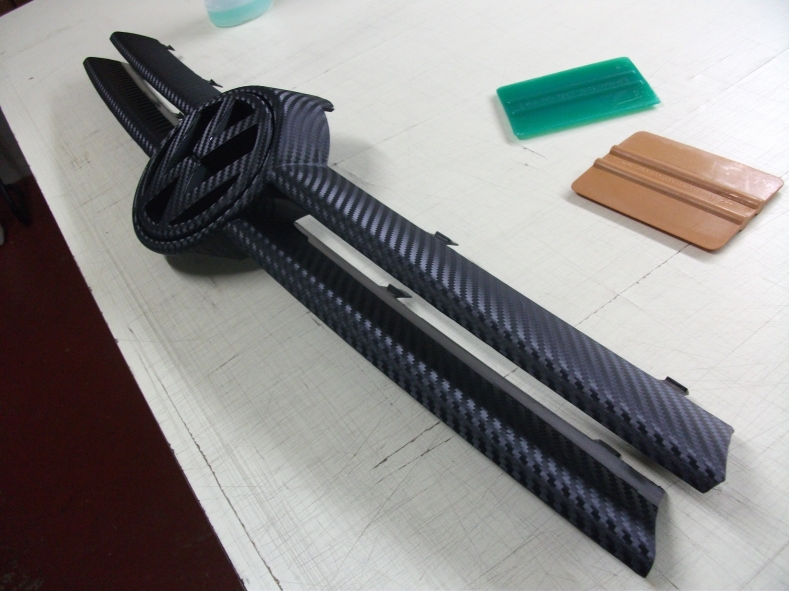

    Here’s the pictures of the mirror i wrapped and the grill for my own car. Speaking of which I am wrapping in 3M 85 series Matt White. Anyone any tips or pointers for me on this?? Any help would be brilliant.

    Looks ok to me. I’ve got some of the 3m c/f but not used it yet, have tried the APA c/f on the wing of my van, wasn’t too bad.
    Did you find it awkward on the return, coming inside the actual mirror?
    Bob
  • Nicholas Gormley
    28 March 2010 at 19:14
    Found it a bit awkward on the return inside the mirror and the material bunched up a bit. Think practice is just the best way to get it right, tho if there was another way to do it I would love to find out how???
