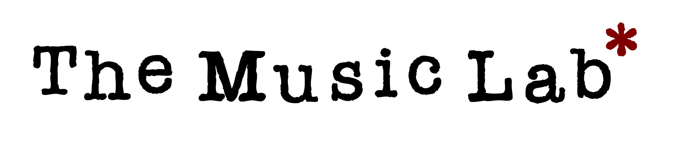

    I am trying to supply the attached logo/lettering made from perspex to stand off from the wall with locators.
    Just wanted some advice from forum members as i wasn’t sure if the text in the design was too jagged on the edges to be made from perspex?
    I will speak with a supplier later, but wanted to ask here to discuss the possibilities of how to produce this.
    The customer wants it fitted on an internal wall, the size will be 2432mm long giving you an individual letter height of 199mm approx.
    Do you think the edge is too jagged to be made from perspex? This is already the simplified version i have produced from their logo which is really jagged.
    They basically specified they wanted it somehow 3d in flat cut letters, so anyone got any other good ideas or options of how i could produce this. It’s going onto a white plywood background inside their offices.

    29 April 2010 at 12:31
    i am guessing, but a cnc router will cut it fine. as long as they use a narrow bit. 3mm bit should do it. laser router would do it best but still… 3mm bit should be fine.

    ahhh waite a second mate… just re-read your post.
    im thinking flat-cut raised perspex letters, you mention 3D? by that you mean built-up 3D?
    NO, Your never getting the sides of those letters fabricated as a built-up.
    however, you could try getting 19mm thick foamex flat cut. but you may struggle with it in black. i have only used white.
    alternatively you could use HDU = High density urethane board.
    you can get it in various thicknesses or it can be stacked glued and sanded then primed and sprayed.
    there is also the option of polystyrene cut letters. then painted but im not sure the finish you are looking for. or how close they will be viewed.
    UKSG member Fran Hollywood on these boards does styrene cut letter & graphics… very good at his job too!

    Just done a job with a similar jaggy font and actually looked good where it went. All done by About Signs (Fabricut), not the cheapest, however they are very good quality and have fantastic customer service…..
    Locator’s will raise the letter some 15 to 20mm from the wall and can be combined with vinyl on the wall to give a shadow/outline effect.

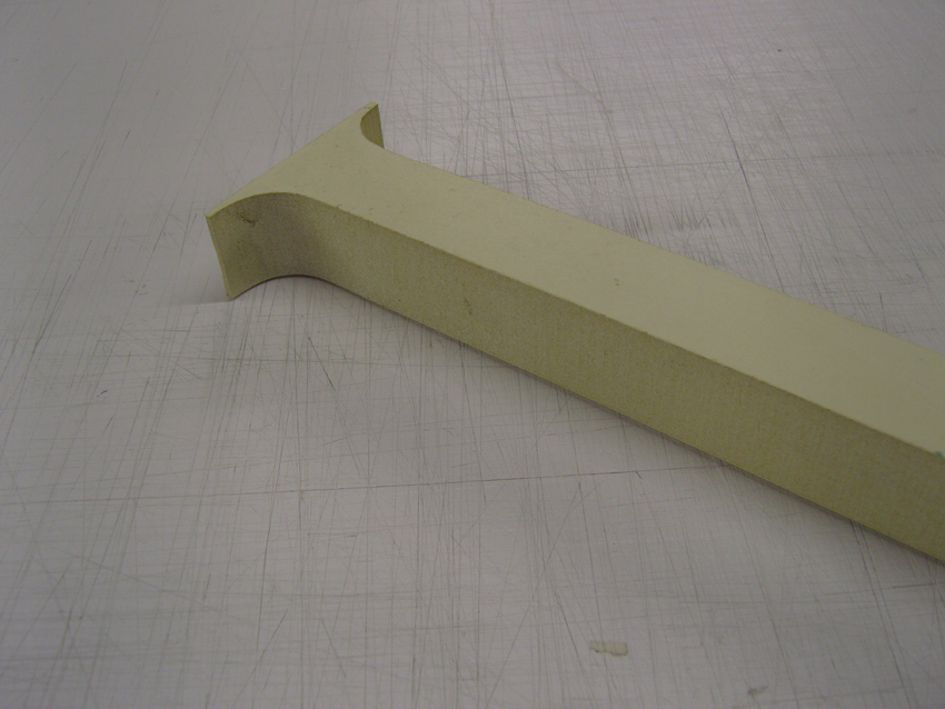

    Here’s one I did in 10mm perspex. The 10mm has a chunkier look than the usual 5mm and being self coloured will last indefinitely.

    Hi Peter, thanks for uploading the pic, great work. Who supplied you the 10mm, think my edges may be too jagged for 10mm but think 5mm will be ok.

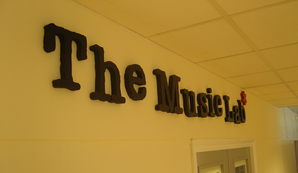

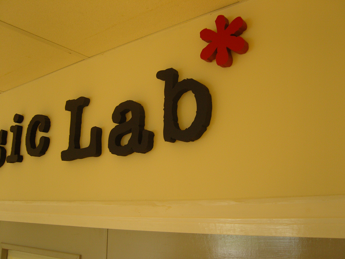

    Just to complete this post in case anyone is interested, here is the finished product, 1 inch polystyrene card faced, matt finish-
    Customer was happy with the job and has asked for a second set of letters the same, but for exterior, so i will probably be asking for some advice on those next week!
    thanks again to those who offered advice on this
    Liam
    P.S These letters are not meant to be in a straight line before anyone says they look like they’re on this p*ss 😉

    No but the kerning is out a little…. :lol1:

    That’s why i took all the pictures at funny angles 😳
