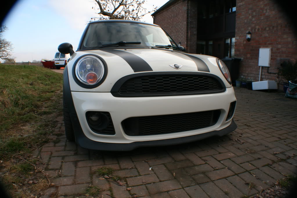

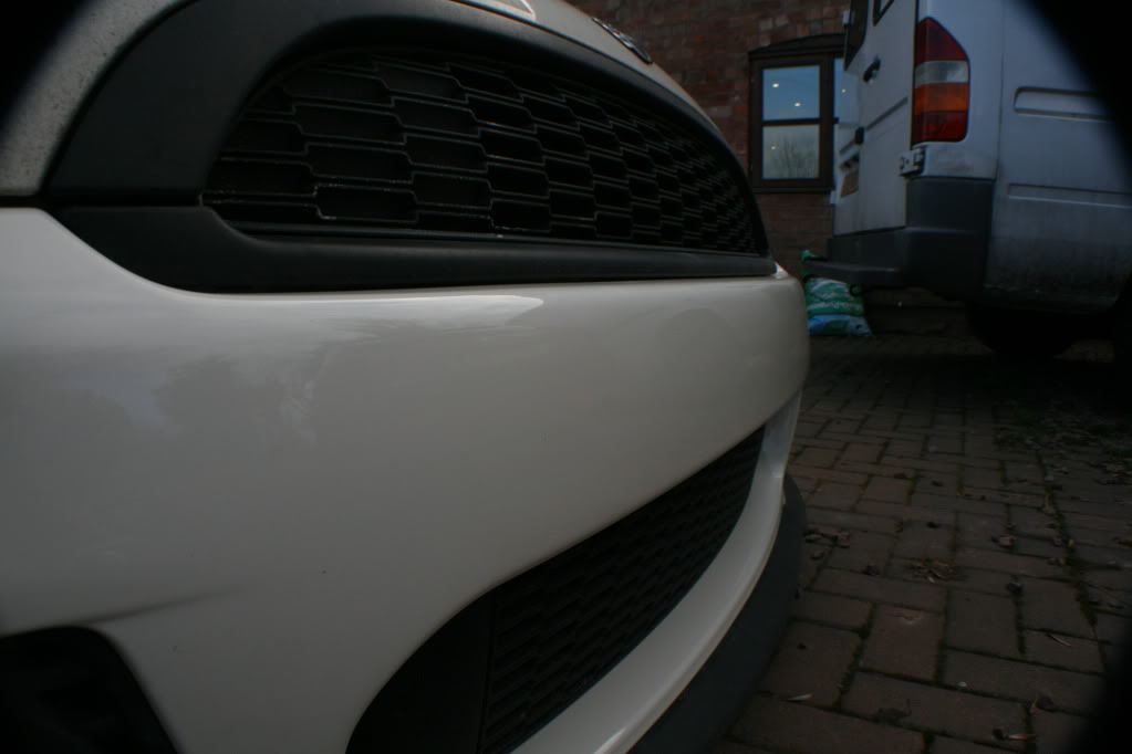

    I recently attended a level 2 Hexis wrapping course, and am going to be attempting to wrap 2 vehicles. Firstly – a new (59 plate) shape smart car, and my R56 MINI. The smart car, I am pretty confident with and think I will be able to do it fine, however the MINI had a very deep recess on the front bumper. I would like to do it in one piece if possible but think it may be too deep a recess here is a picture of it:

    as you can see the recess is quite deep, any advice much appreciated! going to strip the car inc door handles, aerial, filler cap surround, light rings, rear light rings, rear lights, belt line, roof guttering and grill surrounds. as ive done all the work on the car myself taking these bits off isnt too much hassle, hoping removing them will ease the application of the vinyl. Using Hexis HX20000 military matt green.

    here they are…uploaded according to ‘forum rules’

    Should be able to do that recess without a problem, would suggest a practice with a black or white offcut first(if you have one), if its your first attempt at one as from memory the military green is over twice the price of basic gloss colours and would be painful if you did have an issue.

    id say that recess should be fine as there is enough spare material in the grille itself.

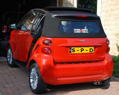

    I think the Smartcar will be much harder to do than the MINI. Especially the rear quarters.

    i dont have sufficient privileges to send PM’s :/ so cant send a PM ian, but wondered if you could give me a little advice – i have started wrapping the smart and its coming along beautifully, really pleased so far, just having a little trouble with the rear quarters. they are really tricky, any suggestions on how to tackle it? (pics attached)
    (red one isnt the one im wrapping, just pic i found) also – i have taken the rear lights out to make it slightly easier

    I’d practice with some cheaper vinyl first, they are tricky for experienced fitters.
