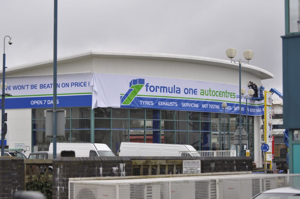

A flex face or similar tensioned banner system would be worth a look at

Going to have a look at flex face!

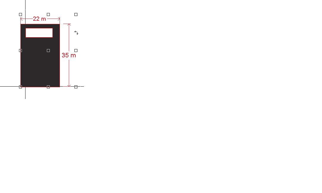

just to put things to perspective,
it would depend on how wide the building is and the viewing distance, as to what would be appropriate at that size and height, I haven’t come across a scissor lift that goes that high though.
and the way to fit would probably involve a crane and a cherry picker, rather than two cherry pickers.
