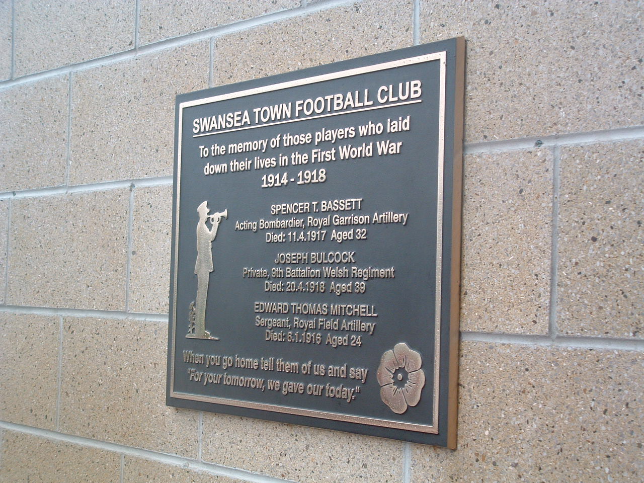

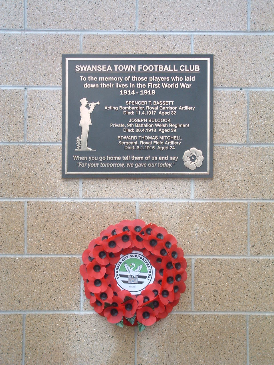

  • Mike Grant
    13 November 2014 at 10:35
    Just a quick update on this. Job all done and fitted in time for unveiling last Sunday.

  • Mike Grant
    13 November 2014 at 11:49
    quote Phill Fenton:
