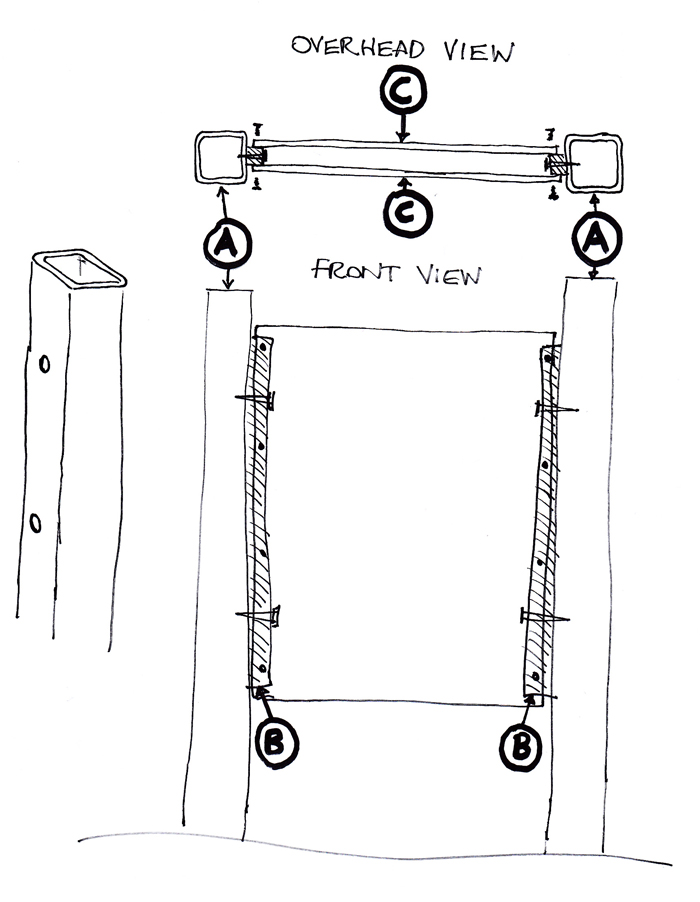

    I’m not 100% sure about how to construct the double sided sign. Please have a look at the attached drawing. The hatch area (B) is meant to represent a timber strip to which the panels (C) are screwed onto. Is this correct? If not how would you build it?

  • Simon Worrall
    13 November 2012 at 09:15
    I cant see anything wrong with it.
  • Neil Beckett
    13 November 2012 at 09:23
    Thanks Simon!
    How do I secure the timber strip to the post as its hollow and nothing to "bite" into. Is there something similar to plasterboard screw for this?
  • Mike Grant
    13 November 2012 at 10:16
    Just use a decent sized self tapper, job done.
    Or you could insert a wood strip inside the post to screw into.
  • Neil Beckett
    13 November 2012 at 10:26
    Thank you Mike, Much appreciated!
  • Jack Hendrie
    27 January 2013 at 14:41
    that works perfect i would use aluminium angle rather then timber so i could use rivets to mount the boards rather than having to use screw caps

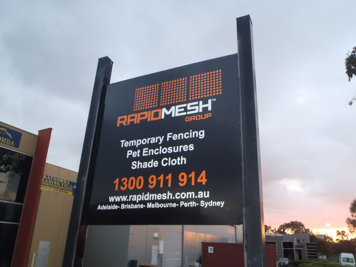

    Here’s a pic of the completed job which was my first post and panel sign.
  • Jack Hendrie
    27 January 2013 at 21:32
    Nice I’m a big fan of black and orange as well 🙂

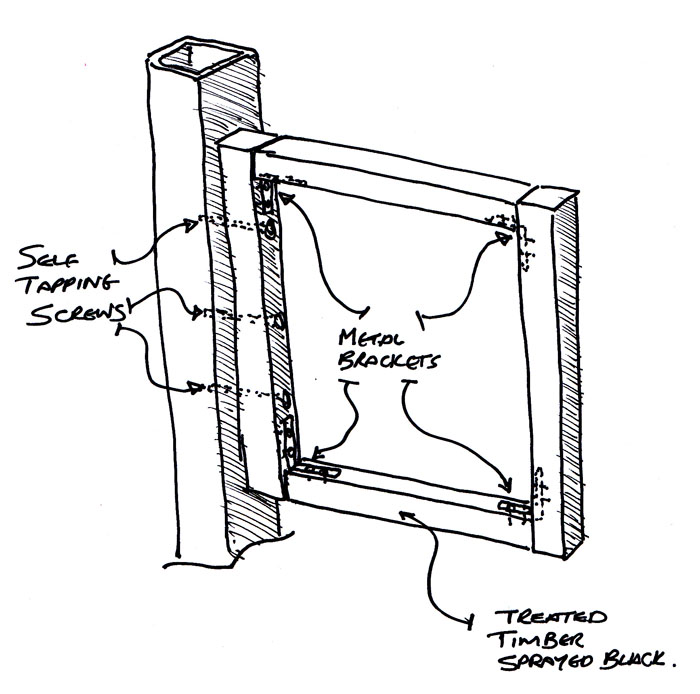

    To make the panel stronger and stop any flex of the double sided panels I made a complete frame like this…
