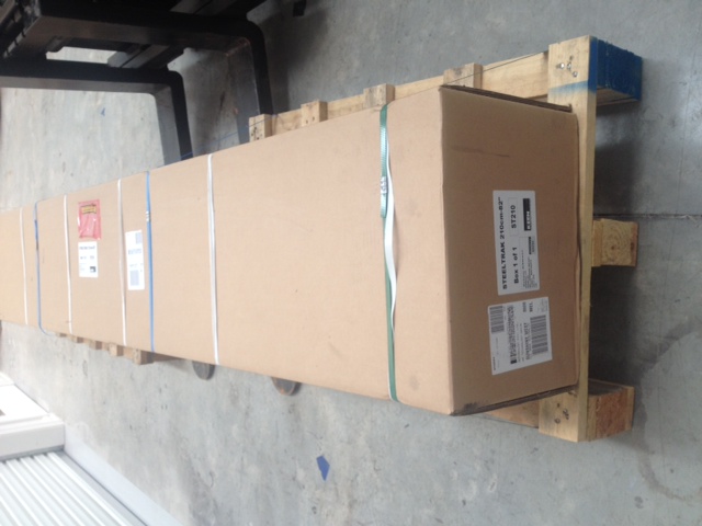

    4 September 2012 at 06:05
    Anyone want to set it up for me.
  • David Rowland
    4 September 2012 at 07:19
    not strong enough to lift it Jason ? 🙂
  • Jason Xuereb
    4 September 2012 at 07:20
    Not tall enough to reach the top of it Dave. I’m as tall as Rob.
  • David Rowland
    4 September 2012 at 07:33
    ah an small offcut cutter lol
  • Warren Beard
    4 September 2012 at 09:33
    No thanks mate, did my own one a while back and took quiet a bit of fiddling to get it all squared up etc
    Good luck but once it’s up it’s a great cutter.
    cheers
    Warren
