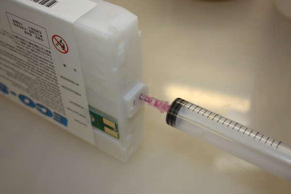

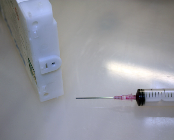

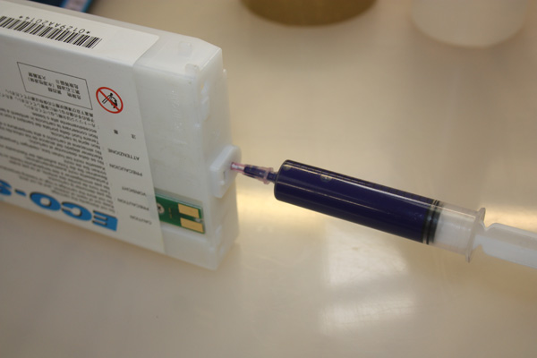

  • Mo Gillis-Coates
    4 August 2011 at 13:42
    Ok, I’m going to post a picture, but as Chris says, please don’t do this on my say so, at least wait to see what happens with my system. Although I should point out that I have been running bulk ink systems and refilling carts for many years now on various printers..
    But please only do this if you just want to check the wastage!
  • Mo Gillis-Coates
    4 August 2011 at 13:53
    Ok, initially you will get some resistance, this is just the rubber seal inside the cart where the ink is sucked out of, so you will need to use some force. Only do this to check the remaining ink in your carts.
    I will also dissect a cart later and take some pictures so that you can see the composition of the cart inside.
    I agree with Chris, that you need to have a buffer ink section so that no air gets in to the lines, but 20% of the ink in the cart? C’mon! 😮

    Inside those carts is a plastic foil bag be careful not to Peirce the bag with the needle.
