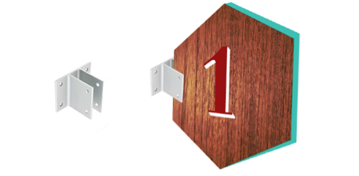

    I was wondering if I could ask for some help, I’ve recently been given the job of creating 50 numbered signs for an indoor market and I’m finding it extremely hard to find reasonably priced brackets to place each sign on. To make it harder on myself each sign is a hexagon!
    Myself and my colleagues wanted to have each sign swing, but the only reasonable alternative seemed to be a bracket, illustrated below – although practical its not the greatest looking thing..
    Each hexagon measures 25cm point to point
    I’m curious to hear if any of you experienced folk have any ideas!

    Looks light and for indoor so how about these small plastic flag-poles you see fixed to the wall with a couple of screws and angled at ~ 45 deg or so. Hang the signs using nylon fishing line to the two top corners/shoulders – something like that?

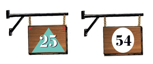

    We initially wanted something like below (ignore the rectangle design) but its quite pricey when you want 50 or more, so looking for a cheap alternative, or if you have any other suggestions that would be grand.
    thanks
    4 January 2013 at 14:26
    Have you tried a local blacksmith for prices? Might get a better price that way on a quantity of 50. Other thing is that I wouldn’t use ply for the job, far to time consuming with sanding, priming & painting. 3mm composite would be ok for the job, easy to cut & ready to put graphics on with a quick wipe to clean.

    The bracket could just be a flat plate, screwed from the side into the edge of the MDF (needs to be thick enough), so you don’t have the ‘flanges’ coming into the hexagon either side which spoils the look??
    If you are having the MDF pieces CNC’d why not get the fixing plates milled at the same time in similar hexagon shapes to match, or ovals – brushed (Butler) alicomp would be good. I’d make the height of the plate the same as the edge of MDF touching the wall, will look better and wont wobble.
