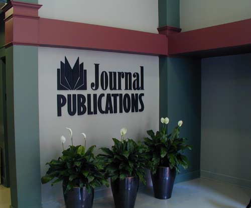

The picture below is of a recently completed “simple” dimensional job. All copy and logo elements were router cut from Medium Density Fiber (MDF) board, lightly sanded, spray-bombed Flat Black, and attached to the Drywall with 3M VHB tape. Nothing fancy, just another everyday job that helps to pay the bills. I chose pictures from this particular job for my “educational” experience.
This file was opened in Photoshop 6.01, RGB mode. My first step was to copy the entire layer to the clipboard. If you wish for the entire image to look like a pencil sketch, this step is not necessary. Next, create a New Duplicate Layer. Convert the image to Grayscale. It’s important when prompted, to select Don’t Flatten. The picture below reflects the changes so far.
