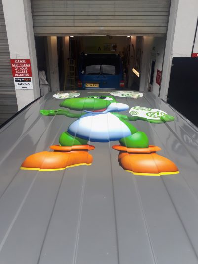

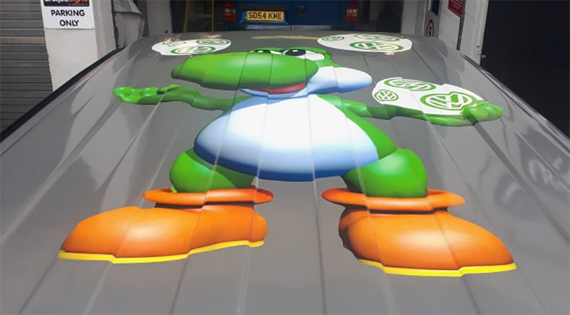

    Any thoughts on this one?
    Roof wrapped in Avery Supreme Silver. Then left overnight. The Yoshi had been printed on MPI 1104. Left to gas for 48hrs, laminated, left another 24hrs then fitted. All recesses were heated in, then post-heated to 100 degrees.
    A week later the customer returned as Yoshi was popping in the recesses.
    We reprinted him, again with the same process. I fitted him yesterday. The Silver had not budged at all. Kept the van overnight and blow me, if it wasn’t popping again.
    Do you guys think that it was down to the fact that this is a GRP roof? I’m following every procedure as I always do, to the letter.
    Any thoughts at all?

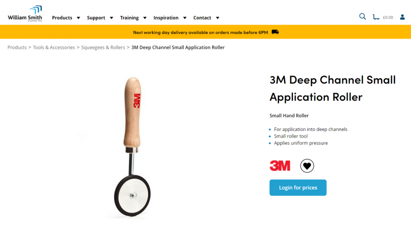

    To make sure the actual adhesive coating is in full contact in a recess, more pressure is required to collapse the beads/pyramids/air channels of the vinyl. I use a pressure wheel regardless of the adhesive system or brand of vinyl. I have attached the testimonial video i done for Arlon, you will see i even use the wheel in this whilst applying heat at 2.30mins. you want the vinyl as hot as a fresh cuppa tea while you apply. once you have completed the entire recess, go back and post-heat right after.

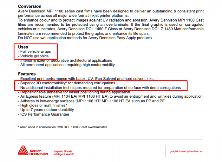

    What I will say though, is that the vinyl should be more than capable of doing this job and if you have ticked all the boxes throughout your process. You need to consider “has the vinyl failed?” If you look at the attached, it clearly states it is up to the job, and some!

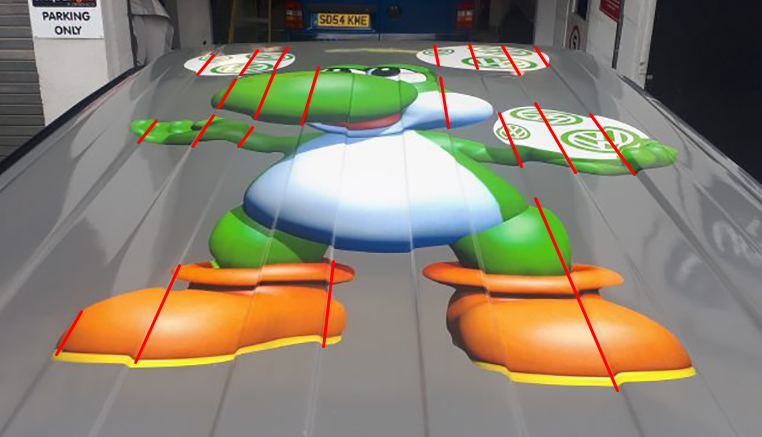

    in the attached image, you will see red lines. you could actually fold the vinyl in and out of the recesses without in tension created at all. easier if you had a second pair of hands, but you could go as far as to fold in and out the whole thing, meaning a decent polymeric would do the job!
