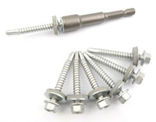

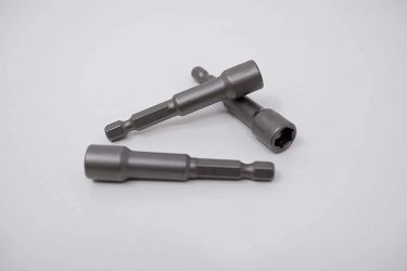

    the best way to do this is to also remove the tech screws in the areas your fitting. as soon as the vinyl applied. just screw them back in using a cordless drill. very quick and easy.
    You will need a “tech bit” for your cordless gun. check the tech screw sizes also, some are larger coloured plastic/nylon ones, but most are plastic caps on the tech that you can easily remove.
