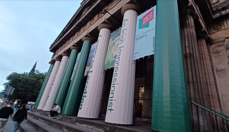

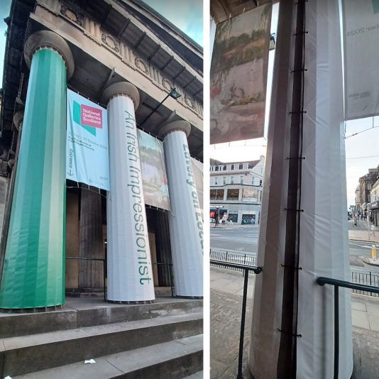

    This is obviously NOT vinyl wrapped, but I thought I would attach the pictures, purely for options and reference to solving a problem for externally wrapped concrete pillars.
    I took these photos in Edinburgh a couple of months ago. a very simple fixing concept that appears to work fine. I did initially think that the bottom tie wraps could have been the metal types to prevent someone from cutting the first 6ft of the plastic ties, but then I thought, if they could snip the plastic ties with a blade, they could easily slit the banners! ๐Ÿคจ
    Anyway, it’s just another solution for wrapping pillars. ๐Ÿ™‚

      thats clever. i would not have thought of that. very simple idea too. ๐Ÿ˜Ž
