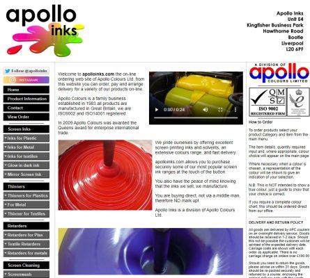

    if it’s just Foamex, like the title says. I would consider “ink”.
    Buy it from apollo inks http://www.apolloinks.com
    Ink goes much further than paint and is ideal for bonding to plastic, like foamex. It also dries within seconds/minutes, where spray takes a fair bit longer. increasing wait time between coats.
    As foamex is PVC, it will expand and contract a lot during the day/night. Therefore certain spray paints and primer would be required to prevent flaking. The ink wouldn’t.
    You should also check from your ink or paint supplier that you chose, the type of life expectancy of the warm colours.
    If you do speak to apollo inks, tell them exactly what your painting and the life you hope to give on colour stability and they will specify you the correct ink to use.
