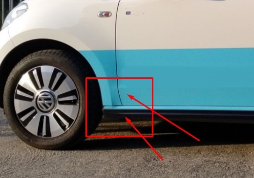

    I might be wrong, but looking a bit closer it looks like there are either two colours here or the sill is maybe a plastic moulding?
    I do not know how accurate a match to that colour it must be, but if it has to be exact or very close. you can have varying colour output dependant on the machine and print media you are using. So you may have a bit of colour matching time to spend on whatever vinyl you use “IF” the colour has to be spot on.
    Personally, If close, is all that is required, I would see if I could get a solid colour wrapping vinyl, match. That said, there is no real need for a wrapping cast. a standard cast vinyl would have a much better colour range than that or a polymeric. but either polymeric or cast would be sufficient for this application.
    Just stick with a good brand of vinyl using a polymeric or cast vinyl and you will be fine.
    Obviously, prepping and finishing the vehicle properly still needs to be done and make sure it’s done in the correct temperature or heat before and after to promote the proper adhesion, because the weather is getting worse and cold metal vehicle bodywork increases fails!
