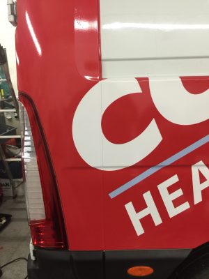

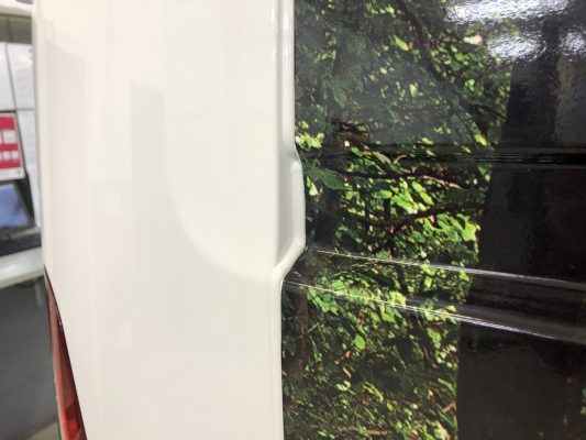

    I have just realised this van looks like a van we did a part wrap on early last year.
    If you look at the area I have indicated with red arrows below. This WILL cause you problems in a couple of ways. It has one of those raised joins right in the recess of the van. I forget exactly how we addressed this but from memory, we had to feed/fold into, cut and overlay a part. very hard to explain, but thought I would make you aware of it.
    I would advise printing an extra splice just down this area a few inches wide by the depth for overlaying purposes once you cut it. I say that so you have a colour matched spare bit to use.

    I know what you mean Robert. In my case image stays on face panel. This is not a full wrap. I did as you suggested. Wrapped the sealing and then made a cut.

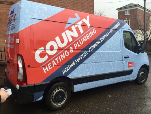

      Very nice! out of interest, where are the drops on this/joins if any?
      • Kevin Mahoney
        January 21, 2021 at 6:34 am
        Hi Martyn.
        Rear section at the tail lights
        Horizontal join along waistline, door & front wings done as drops

      I cringe whenever they call Chris, they buy this model every time & I loathe the vans. So much extra faffing about because the manufacturer can’t be bothered to make a proper long wheelbase, just glue an extension on. Just that extra bit on the back adds hours to the job

    I am still a bit stuck in imagining how this is done. is the vinyl heat shrunk into the recess in one piece or cut and bits laid in?
  • Kevin Mahoney
    January 21, 2021 at 2:12 pm
    I start with the back end & wrap over the mastic bead, little to no heat. I then lay on the lower section onto the side, again leaving the material as relaxed as possible, & go over the bead again from the other side.I lay on the top piece & line up, remove the bottom section of liner & fit, hinge down & fit the top out as normal. Door then front wing, followed swiftly by the pub. Been a while since they’ve been in

        Everything about these vans is a minefield to be honest. The flexible sealant is designed To be just that, flexible & always moving & always gassing off, forever. Then there’s the deep recess on both sides just to make life fun. The vehicle designers wife clearly ran off with a sign writer as this van is one of our worst enemies.
        I prefer the overlap to be below any stretching required, going on at full strength for 50mm before you start heating & stretching. I don’t like stretching too much on these vans as there are failure points everywhere you look. The horizontal join is barely visible as opposed to drops going across a recessed panel. That would keep me awake at night
