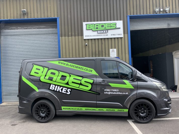

    I’m not a vehicle wrapper either but that seems like an odd and untidy way to go about things!
    August 28, 2020 at 3:20 pm

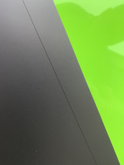

    I don’t think there’s a right or wrong way. But the overlaps certainly look a little large.
    I’m sure some of the green could have been cut in the plotter and butted up, or with a small overlap, even trimmed with a blade and ruler.
    Whether that did cut the green in the plotter, and apply it first, then use knifeless tape to cut the matt black?
    Overall, it’s a nice design, colours… just those overlaps when up close.
    You could trim the overlap back possibly, but that’ll make the green broader, and may need to trim off the other side?

    Really nice design. I wouldn’t personally have done it this way. I would have applied the black first. Right to where the green edges were to be. Then the green on top flush to the edge.
    I would also generally advocate that the green is the same media as the wrap. If the green is calendered vinyl this may cause future problems. Especially under the wrap. Although that’s usually the case in a recess. Might be fine here.

    Green down last personally. As now the grey edge, top layer is facing towards the front of the vehicle.
    Doubt it makes any difference to be honest. But I believe that’s how we are ment to do it. If a slight edge lifted it would be taking the wind of the van moving forward.

    Quality of the install looks really good and they’re obviously experienced at what they do so would assume they’ve done it this way to give the vinyls more dimension. Used as an effect

    either the green or the black has to overlap a bit. Maybe it is a bit much, but the driver is the only person really who will see this close up.

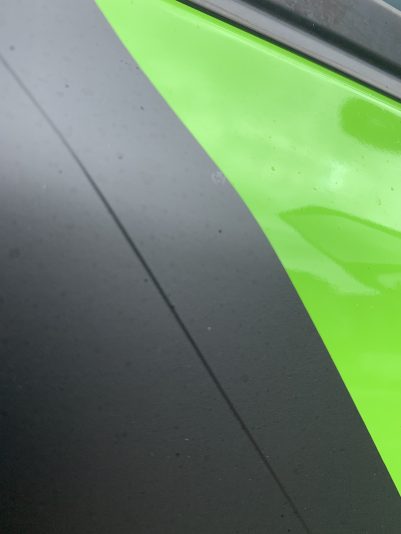

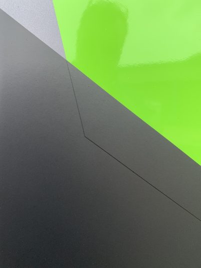

    I think that regardless of our installation preference. If the overlap has to be there, it is far too big!
    Personally, If I was installing it and i wanted the overlap, I think I would have laid the green first too. But my reason for this is the “adhesion”. I do not like to apply a vinyl to any textured surface, such as matt, or brushed etc unless it has a high gloss finish.
    Matt and brushed finish vinyl, tend to have a micro-texture on the surface and can result in the stacked vinyl lifting.

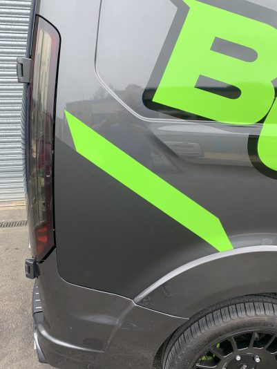

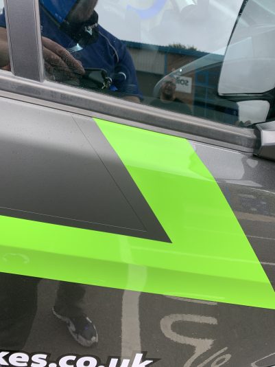

    I hate to point out something in case it is the lighting of the picture. But based on what I can see, I think the wrapped matt black is failing at the top recess where it has double the thickness of the vinyl in the recess.
    You can also see on the door that the entire graphic green panel is overlapped at one part on the door.
    It is most likely the person that is designing has maybe not welded/clipped the graphics on-screen, so they had no option to overlap during the installation as they have already been cut.
    If you can live with the overlaps, then it is a nice van design. but I would bring the failed recess to their attention because that section must be replaced, trying to fix it is not advised, it will be an ongoing fail unless changed.

    The lifting vinyl came up within 48hrs of being fitted and the overlaps are very noticeable from about 2 meters away so even when parked up it looks odd.
    As I say this is a clients vehicle but I didn’t have anything to do with the van as I don’t do wrapping. I just wanted to know if, apart from the obvious lifting should he be accepting the big overlaps as well?

    September 4, 2020 at 8:14 pm
    @Jamie-Palmer
    If you look at where the fail starts and stops. It is on the double layer.
    This can happen if the post-heating over the twin layer is not intense or prolonged enough.
    It is a common failure on vehicles where full wrapped digital prints cross recessed areas, the overlap pops. there are a few reasons for this, but one is if you look closely at my picture.
    The lower layer of vinyl has popped back, lifting the top layer adhered to it.
    This is most likely because the two layers have been post heated while stacked like they are.
    when you take the surface reading with a laser (that’s IF ones actually been used) the reading is taking the “surface” of the vinyl. in this case, the top layer. however, if the heat hasn’t hit the post-heat recommended temperature, then the lower layer will be that bit cooler again. so the bottom layer pops, taking the top layer with it.
    You should be post-heating each layer as you apply it. not sometime later, or later again, when the two layers have been fitted.
    Pull-back tension happens the instant the vinyl is applied and continues to happen until it has been post-heated. you must cure it as soon as possible.

      Absolutely agree Rob. Post heating is so important. I like to post heat a recessed area almost immediately after fitting. Also two layers should always be treated individually.
      I’ve seen a few failures in recessed areas where calandered vinyl is used on top of a cast wrap. Nooooo…..
