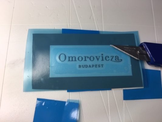

  • Graze
    July 16, 2020 at 2:27 pm
    yes, I’ve done this before, these are supply only though.
    For future reference, I “back weed” tons of stuff.
    Cut as normal, weed out centres (don’t have to do this now), cut any weed lines by hand with a scalpel, mount up, turn over and take off the backing sheet. Weed the outside away while it’s stuck to the application tape, being careful not to touch the adhesive….
    ..works a treat. T
    he small stuff here is 1.5mm high with paintmask used as application tape
