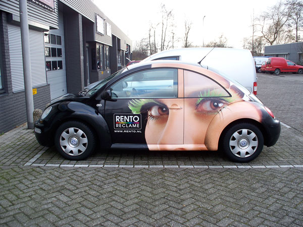

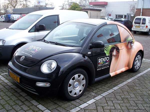

    I recently wrapped my own VW New Beetle. It started off as a silver one.
    First wrapped in solid black and then added a contour-cut full-color print.

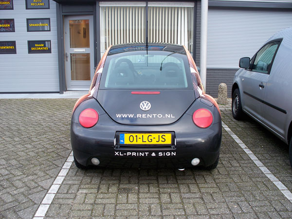

    Our logo is cut in reflective vinyl. The side windows are covered with one-way vision.

    really good and eye catching. what material did you use? nice one. thanks for sharing

    Cheryl, I used Avery Supreme wrapping film for the solid black
    and Avery MPI 1005 for the print

    nice job, so it is not a black beetle at all? how was the material to fit?
    22 January 2009 at 09:06
    Excellent job – well done. Lots of compound curves to struggle with 😮

    Sheryl, it was a silver one indeed, the material was very nice to work with.
    Until now I mainly used Grafityp, but this material is a specific wrap vinyl.
    It’s a new vinyl overhere, has been introduced only a month ago.
    It was the first time I worked with an air-release vinyl, but it surely speeded up the installation.

    did you manage to do the front and rear wings in one piece all the way round? just asking because I am looking at wrapping a beetle soon

    I used one piece for every wing, but I cut a template out of backing paper first and cut a piece of vinyl that was about 10 cm bigger on each side.
    So I ended up with a curved piece of vinyl before i started applying.
    The only part that I had to patch is the recess for the back numberplate.
